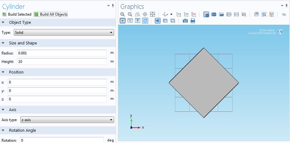

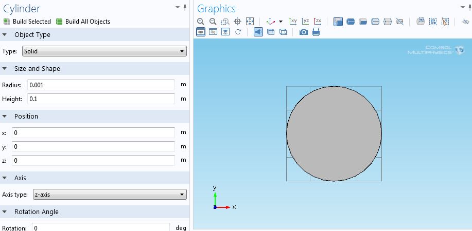

I am building geometry of a wire 10 m long and with 1 mm radius. However, wire's shape is not cylindrical it is rectangular prism, even though I build cylinder. But when change the length of the wire to 0.1 m it becomes cylindrical. I guess this problem is related with the resolution, therefore, can you help me change the resolution or suggest other solution to this problem? Comsol file of my wire is attached.
