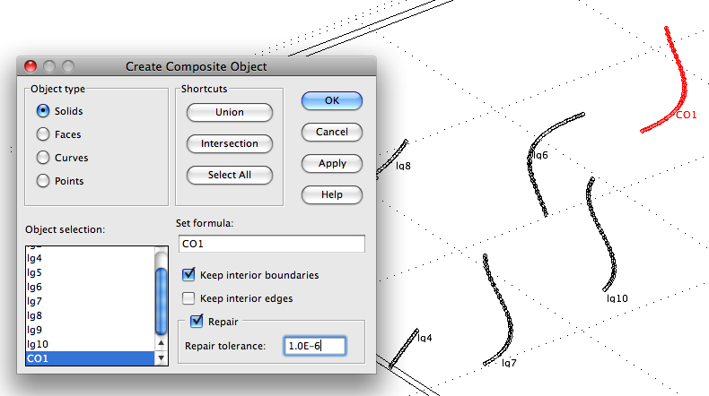

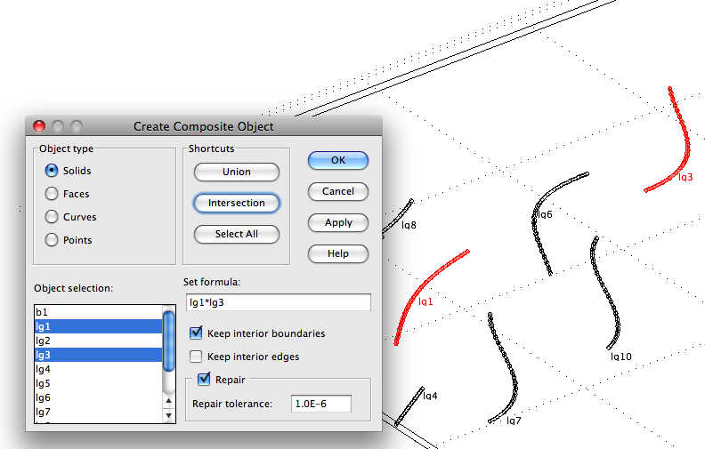

I attached two images to show how that happened.
celina
Hi Ivar, Thank you for your reply. I just double checked, and I am now pretty sure that I did click the 'intersection', not 'difference'. Even I do the intersection operation by hit the (+/-*) as you suggested, the same thing happens. I attached two images to show how that happened. celina

Well I tried before in 2D, did it again in 3D on a PC with V3.5a:
Intersection: BLK1*BLK2 when they do not intersect gives an error message resulting in empty geometry
when the volumes intersect I get the intersection as expected
Difference: BLK1-BLK2 when they do not intersect leaves only BLK1 (BLK2 dissapears)
when they intersect I get the difference (but the rest dissapears in this case BLK2 as above)
For me this is very logical.
From your images, are you using a mac ? or unix ?
there might be an issue there, or on the keyboard mapping ?
I would propoe to pass by COMSOL support, by documenting carefully (images plus fomulas, even screen snip/dumps of the fomulas, that helps. Do not forget to give them version and OS
Good Luck

Hi Ivar,
The OS question is a really good call. I was using Mac, but I just tried the same operation on the same geometry objects in Windows, no problem at all. And yes I am using V3.5a
Celina
Hi Ivar, The OS question is a really good call. I was using Mac, but I just tried the same operation on the same geometry objects in Windows, no problem at all. And yes I am using V3.5a Celina
