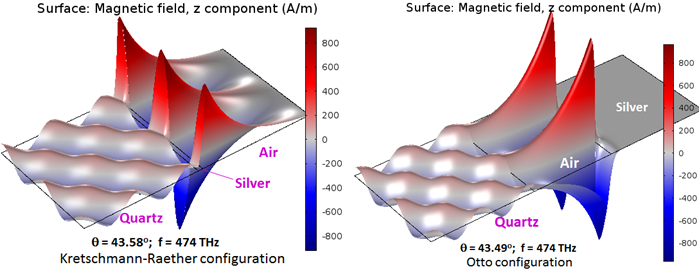

Both RF and Wave Optics physics interfaces can be used to solve this problem.
There are several papers from Comsol conferences about surface plasmon resonance for both Kretschmann-Raether and Otto configurations – try to search keywords “surface plasmon resonance”.
Sergei
Shreyas, Both RF and Wave Optics physics interfaces can be used to solve this problem. There are several papers from Comsol conferences about surface plasmon resonance for both Kretschmann-Raether and Otto configurations – try to search keywords “surface plasmon resonance”. Regards, Sergei
