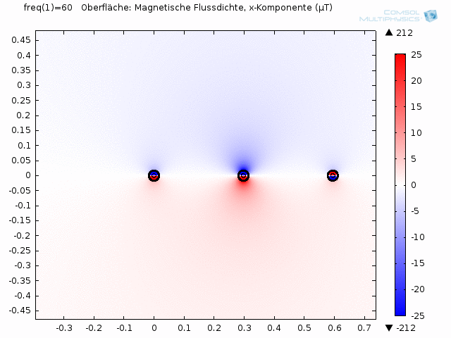

Posted: 1 decade ago 16.06.2014, 05:23 GMT-4
Ok, i have your 2d and 3dmodel. I think this is difenitly a 2d Problem. The 3 cables have the exactly the same cabel or maybe it a 3phase curren width 120deg angle between the phases. see the model
sorry for my bad English
Ok, i have your 2d and 3dmodel. I think this is difenitly a 2d Problem. The 3 cables have the exactly the same cabel or maybe it a 3phase curren width 120deg angle between the phases. see the model sorry for my bad English

Posted: 1 decade ago 17.06.2014, 05:14 GMT-4
Dear Akim,
i have solved yout 2d model.
freq = 60Hz
R L1 (mΩ) = 5.73224
R L2 (mΩ) = 5.72243
R L3 (mΩ) = 5.69881
L L1 (nH) = 441.67833
L L2 (nH) = 362.688
L L3 (nH) = 334.39856
Z L1 (mΩ) = 5.73224+0.16651i
Z L2 (mΩ) = 5.72243+0.13673i
Z L3 (mΩ) = 5.69881+0.12607i
hope it help you. The 3d Simulation take a while. Becaus the 3 D Model is not finished and I didnt found any port or coil configuration.
regards Viktor
Dear Akim, i have solved yout 2d model. freq = 60Hz R L1 (mΩ) = 5.73224 R L2 (mΩ) = 5.72243 R L3 (mΩ) = 5.69881 L L1 (nH) = 441.67833 L L2 (nH) = 362.688 L L3 (nH) = 334.39856 Z L1 (mΩ) = 5.73224+0.16651i Z L2 (mΩ) = 5.72243+0.13673i Z L3 (mΩ) = 5.69881+0.12607i hope it help you. The 3d Simulation take a while. Becaus the 3 D Model is not finished and I didnt found any port or coil configuration. regards Viktor
