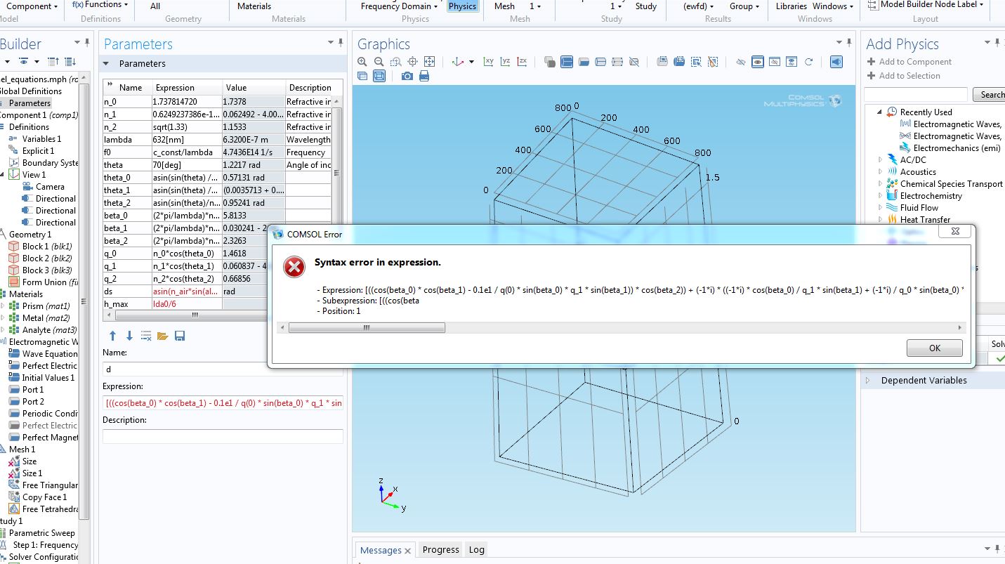

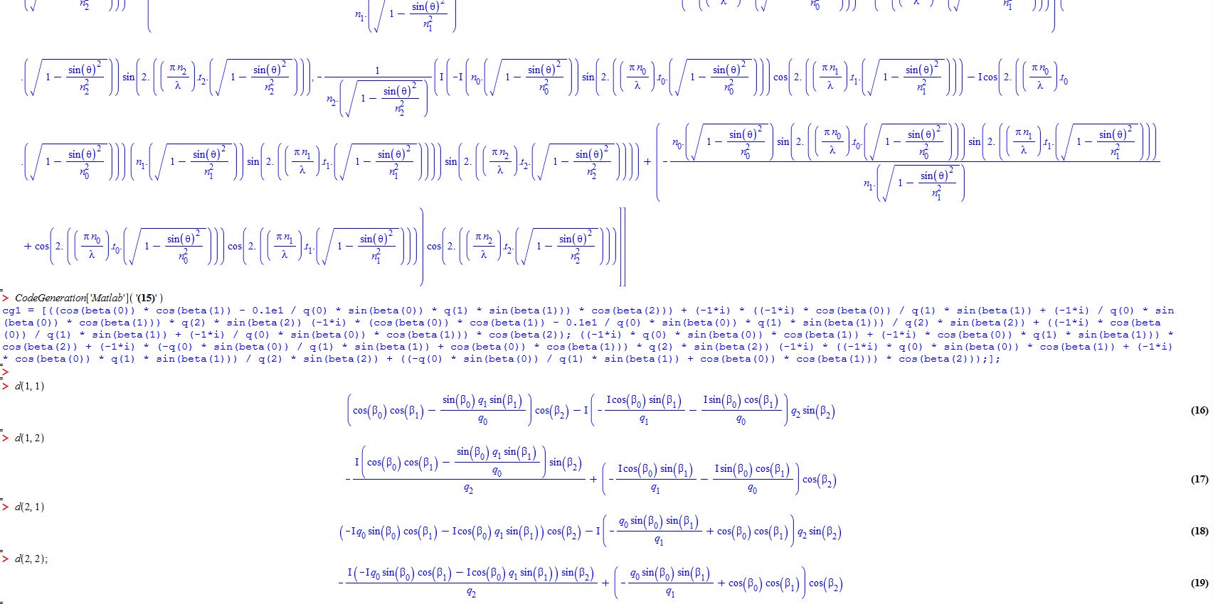

I got a very complex expression in Maple and I want to substitute the expression in COMSOL. For this, I tried to express the Code in Matlab using Right Click - Language conversions - Matlab. Please refer d.jpg
For which I got the MATLAB expression. This I tried to copy paste into the corresponding value of the parameter for which I got the following error as shown in f.jpg

That's quite an expression! Just a guess: it might be the square brackets. Those are normally used for units in COMSOL.
If more is wrong, then you will have to find the syntax error.
