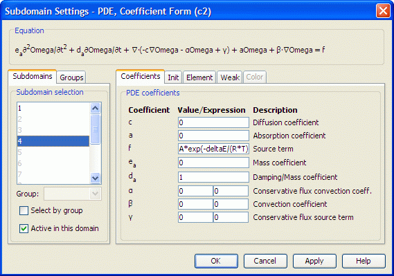

Posted: 2 decades ago 29.10.2009, 15:29 GMT-4
Here is what I have done...
Use the PDE, Coeffient Form (c)
Select the subdomains that will be active for the calculation... In Roberts case, the tissue...
Set f (source term) to A*exp(-deltaE/(R*T))
Set da (damping/Mass coefficient) to 1
All other variables to 0
I use Omega for c when I initiate the physics in the modeler...
Your equation will then be dOmega/dt = A*exp(-deltaE/(R*T)) or rearranged dOmega = integral (A*exp(-deltaE/(R*T)),dt) - see attached...
Here is what I have done... Use the PDE, Coeffient Form (c) Select the subdomains that will be active for the calculation... In Roberts case, the tissue... Set f (source term) to A*exp(-deltaE/(R*T)) Set da (damping/Mass coefficient) to 1 All other variables to 0 I use Omega for c when I initiate the physics in the modeler... Your equation will then be dOmega/dt = A*exp(-deltaE/(R*T)) or rearranged dOmega = integral (A*exp(-deltaE/(R*T)),dt) - see attached...

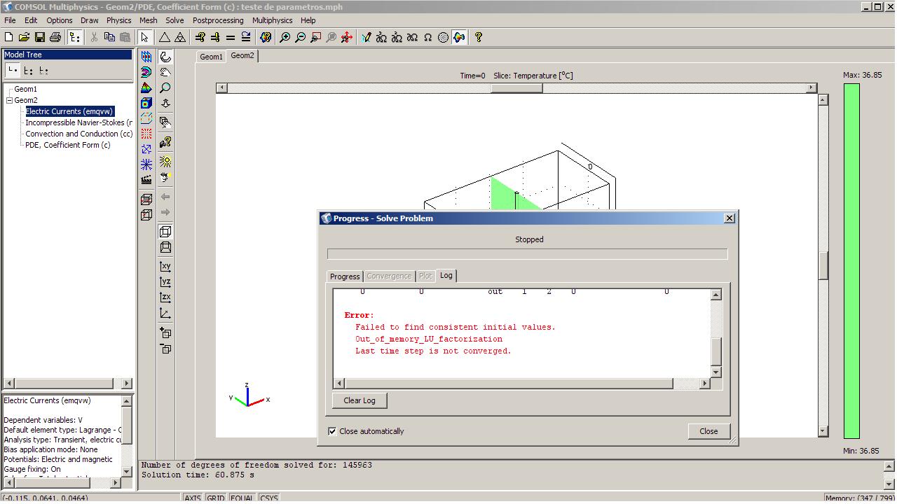

Posted: 1 decade ago 18.04.2012, 21:42 GMT-4
Hi Jason,
I need help! I am trying to apply an Arrenhius damage integral DURING the solution of an thermal ablation problem using the heat Transfer and PDE coefficient form Modules (T and u are the dependent variables). In the end of the simulation, it appears the following message:
"Error:
Failed to find consistent initial values.
Out_of_memory_LU_factorization
Last time step is not converged."
Any help is WELCOME!
Cleber
Hi Jason, I need help! I am trying to apply an Arrenhius damage integral DURING the solution of an thermal ablation problem using the heat Transfer and PDE coefficient form Modules (T and u are the dependent variables). In the end of the simulation, it appears the following message: "Error: Failed to find consistent initial values. Out_of_memory_LU_factorization Last time step is not converged." Any help is WELCOME! Best regards, Cleber

Posted: 1 decade ago 26.04.2012, 12:36 GMT-4
Hi Jason!
I have committed a mistake: I forgot to inform the description of fluid mechanics on my simulation. Actually, I am using the heat transfer, PDE coefficient Form(c) and incompressible Navier-Stokes modules. The u variable describes the fluid velocity in this last modality of Physics.
The values for Ea and A are:
Ea=6.65x10^5 J/mol;
A=1.98x10^106 1/s
The link below illustrates the window of the software COMSOL:
www.comsol.com/community/forums/general/download/file/12973/error%20Failed%20to%20find%20consistent%20initial%20values.JPG
Sincerely yours,
Cleber Pinheiro
Hi Jason! I have committed a mistake: I forgot to inform the description of fluid mechanics on my simulation. Actually, I am using the heat transfer, PDE coefficient Form(c) and incompressible Navier-Stokes modules. The u variable describes the fluid velocity in this last modality of Physics. The values for Ea and A are: Ea=6.65x10^5 J/mol; A=1.98x10^106 1/s The link below illustrates the window of the software COMSOL: http://www.comsol.com/community/forums/general/download/file/12973/error%20Failed%20to%20find%20consistent%20initial%20values.JPG Sincerely yours, Cleber Pinheiro
Posted: 1 decade ago 26.04.2012, 18:59 GMT-4
A citation only:
The variables used in the simulation are:
T - HEAT TRANSFER MODULE;
u - VELOCITY OF THE FLUID;
u2 - VARIABLE FOR PDE COEFFICENT FORM (c).
The damage integral is defined as u2=integral(A*exp(-Ea/(R*T)dt). Moreover, one solves the equation d/dt(u2)=A*exp(-Ea/(R*T). I use u2 to designate Omega. The source term f is equal to A*exp(-Ea/(R*T))
The boundary conditions are set up as follow:
1) ZERO FLUX;
2) INITIAL VALUES: u2=0 and d/dt(u2)=0.
Best Regards,
Cleber Pinheiro
A citation only: The variables used in the simulation are: T - HEAT TRANSFER MODULE; u - VELOCITY OF THE FLUID; u2 - VARIABLE FOR PDE COEFFICENT FORM (c). The damage integral is defined as u2=integral(A*exp(-Ea/(R*T)dt). Moreover, one solves the equation d/dt(u2)=A*exp(-Ea/(R*T). I use u2 to designate Omega. The source term f is equal to A*exp(-Ea/(R*T)) The boundary conditions are set up as follow: 1) ZERO FLUX; 2) INITIAL VALUES: u2=0 and d/dt(u2)=0. Best Regards, Cleber Pinheiro

Posted: 1 decade ago 27.04.2012, 14:02 GMT-4
Have you been able to run the thermal/fluid interaction without the Arrenhius damage integral? If the thermal/fluid interaction does not solve, that may be where your error is coming from.
Posted: 1 decade ago 16.05.2012, 23:54 GMT-4
Hi Jason!
yes, I run the thermal/fluid interaction without the Arrenhius damage integral (NO PROBLEMS in this simulation). So, the thermal/fluid interaction is independent of the damage integral.
Cleber Pinheiro
Hi Jason! yes, I run the thermal/fluid interaction without the Arrenhius damage integral (NO PROBLEMS in this simulation). So, the thermal/fluid interaction is independent of the damage integral. Best regards, Cleber Pinheiro
Posted: 1 decade ago 24.02.2013, 19:29 GMT-5
Hello all,
Here's something that pertains to discussion! The problem of convergence was resolved. Only I modified the mesh characteristics. I used the mesh type "fine". However, the arrhenius damage integral assumed negative values in COMSOL MULTIPHYSICS. What's this mean? What is the meaning of these values​​?
Sincerely yours,
Cleber Pinheiro
Hello all, Here's something that pertains to discussion! The problem of convergence was resolved. Only I modified the mesh characteristics. I used the mesh type "fine". However, the arrhenius damage integral assumed negative values in COMSOL MULTIPHYSICS. What's this mean? What is the meaning of these values​​? Sincerely yours, -- Cleber Pinheiro
