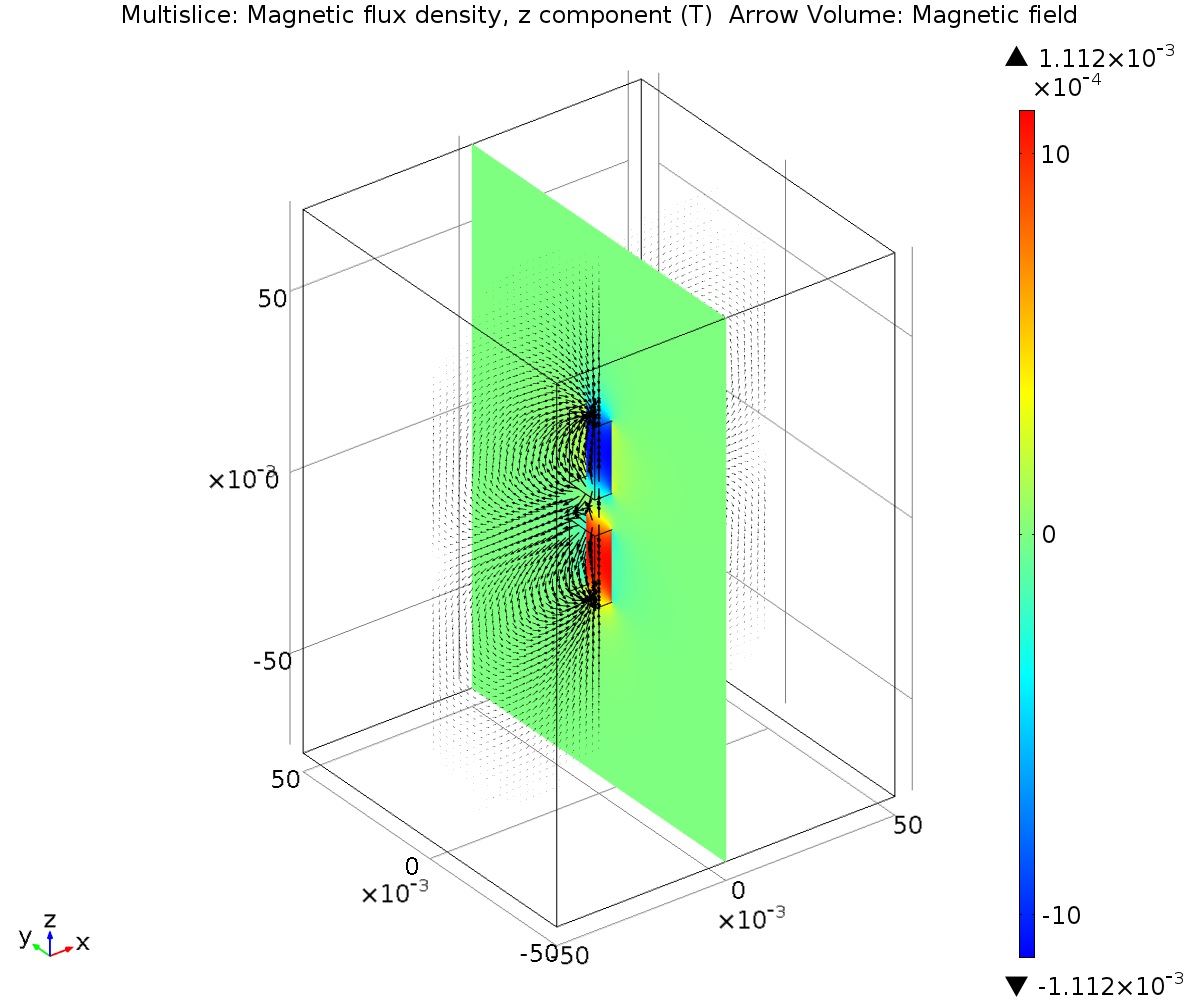

I've attached a basic model (uploaded without the solution to save memory) of what you described, as well as a picture showing the result after execution.

Posted: 1 decade ago 01.07.2014, 21:40 GMT-4
In your file, in the Model Builder, under Magnetic Fields, No Currents, choose Magnetic Flux Conservation (which is already in your list) or create a new one of those if you prefer. Select the domain of just one of the magnets to go with this. In the Magnetic Flux Conservation dialog, go to "Constitutive relation:" Choose "Magnetization". Put a number in for the z-component of M and leave the others zero. Now do the above all over again for the domain representing the other magnet, but specify the opposite sign for the z-component of M. This will point the two different values of M in opposite directions along z.

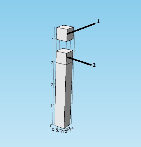

I have attached two models. Magnets are on tip of the rods.
In the first model, I have defined the magnets and fixed the end of the rods ( Solid Mechanics).
And I want to see the two magnets attract or repel each other but it seems Comsol doesn't do the coupling automatically! coupling of Magetic and solid mechanics.
In the second one, I have put body forces to the magnets equal to the force that Comsol Estimates in Magnetic module.
Now my question, is there any way that comsol will automatically calculate the magnets repelling/attracting forces and put it in solid mechanics as BC?
Or the only way is that I have done in second model.
Thank you.
I have attached two models. Magnets are on tip of the rods. In the first model, I have defined the magnets and fixed the end of the rods ( Solid Mechanics). And I want to see the two magnets attract or repel each other but it seems Comsol doesn't do the coupling automatically! coupling of Magetic and solid mechanics. In the second one, I have put body forces to the magnets equal to the force that Comsol Estimates in Magnetic module. Now my question, is there any way that comsol will automatically calculate the magnets repelling/attracting forces and put it in solid mechanics as BC? Or the only way is that I have done in second model. Thank you.
