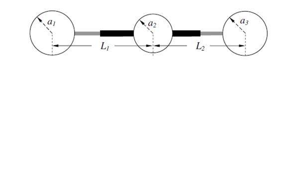

I'm trying to analyze the motion of this sphere-rod system in the fluid.
How do I make the fluid stationery while the rods move? Do I model the rods as walls with slip condition? If I do that, how do I make the sphere move along with the corresponding rod?
I would suggest to start "easy", although mixing 2 physics like that is already challenging, particularly if you are a beginner, but its good to have challenging goals, at least so long you do not despair.
So I would start just with one, two, three spheres, forget the rods and the fluid to begin with, and find the way to enforce linear motion of the two external spheres, if they are moving in a symmetric way, you could consider just one half, by symmetry (calculates quicker, and is hence easier to debug in the beginning, one can always mirror the geometry later and continue with a full model). Then should youattach them with a "spring" to allow oscillations and harmonic analysis.
Once comortable with these simpler models (stationary, transient and harmonic), then only add the fluid and continue wit coupled physics.
A nice project you have there
Have fun Comsoling
PS do not forget to go back to the doc regularly, and do some of the exercices in between, they help to get the feeling for mixng the physics, or just setting up complex models.
So, I have to use two springs between the spheres. Will lines work as springs?
How do I model springs and how do I make the spheres move along with the springs?
Well first I would start in 2D, then you are not really simulating spheres but 1[m] long cylinders, this is again because you can simulate quickly, less than a minute and you can learn better this way, then you might go to 3D, but you could come up in hours of calculations at the end.
So start Comsol in 2D - Structural - Plain Strain (ie pn or smpn), and draw a circle of radius "1" at x=1.5, y=0 (or choose any dimension that fits you better).
You need to define the material of the shpere: "Physics - Subdomain settings - Material tab", let us say its aluminium E 70[GPa] nu 0.3 rho 2750[kg/m^3], thickness (the Z depth leave it default to 1 [m].
There are different ways to enforce motion and attach "springs", but first you must force your spheres to move only along one direction. Constraining the correct boundary conditions (if its along "x") you should set the "v" variable to 0 (select the boundary of your circle in "pn" or "smpn" (if you have the structural modus) and in the boundary conditions you select the boundaries (1,2,3,4 if ou have one circle) and tick Ry=0 and OK and you circle is blocke along the X direction.
Then if you want to attach a spring you must decide where, probably the CoG (centre of gravity), this point you must calculate where it is: "Options - Integraton Coupling variables - Boundary variables"
you select your four boundaries: you fill in "name" and "expression" fields (the rest leave as by defualt) as:
Length 1
X0x x/Length
X0u u/Length
This means that Length is the length (integration of "1" along the circuimference) of your circle = 2*pi*r in this case, but like this your equations are self supporting, if you later decide to change the sizes or scale something, the formulas remain valid as Comsol recalculates everything.
X0x is the integration along the circonference of x, normalised by the length, hence its the mean "x" position of your circle before motion, while X0u is the mean motion DISPLACEMENT, hence X0x+X0u is the position of the centre of gravity after (or during in transient mode) the displacement.
Now you add the spring. Let's say it has a stiffnes of Ks[N/m], the force you excerce (along x) is
Fx = -Ks*u
the product of the spring constant times the displacement divided by the length as the units are normalised as pressures, as this is a restoring force it has a negative sign.
You can put this as a load on the circle boundary (or the full volume, think over and/or test the differences, with "u" or with "X0u" what are the differences ?).
This means that you go to the "Physics - boundary settings - Load tab" and you type -Ks*u/Length for "Fx" important note : check the "Edge load is define ...force/length", then OK.
But "Ks" is not yet defined for COMSOL, this must be done so yuo go to the constants (double click on the Model tree or "Options - Constants" you fill in name and expression:
Ks 1000[kN/m]
I have put any number in here, pls change at your will, the units are important as they help to check the formulas in COMSOL I have selecte "kiloNewton per meter" (even if some functionalities as the Integration variables do not yet transfer correctly the units, and these appread "red").
You are now ready to do a harmonic analysis like this: "Physics - Properties - Analysis type Eigenfrequency" OK and you hit "solve" its the "=" sign. I see 1.7[Hz] the first mode of the spring mass system (the displacement are arbitrary just forget them in eigenfreqy mode.
To obseve the displacements you need to "Postprocessing - Plot parameters select Deformed shapes tick ON" and do an "apply", then select the "Surface" tab and use the predefined quantities and selec x in units "mm". There it is.
Next is perhaps to add a gravity and see the spring expansion, adding gravity means you will add a body force (nowe in comsol you do not add forces [N] but pressures [Pa=N/m^2], but a pressure is nothing else than a normalised Force over area): Go to "Physics - subdomain settings", select your volume "1" and go to the "Load" tab. You now add a gravity along "+x" (because you have bocked the Y direction we need to use X direction to see any effect) and you select Fx = rho_pn*G (or rho_smpn*G if you are in smpn mode), we need to define the "G" "Options -constants" G 1[lbf/lb] OK the [lbf/lb] is just a "trick" to quickly get the gravity acceleration as the ratio of the imperial units "pond force divided by a pound", it is already inside COMSOL but you can also type in 9.81[m/s^2], or whatever you want. Do not forget to check the units:rho[kg/m^3*m/s^2=N/m^3] and be sure you hgave ticked "Body load ... using the thickness".
You select "Physics - Properties Analysis type: Static" OK and Solve OK I get some 84.7[mm]. this should be checked, but for that I need the total mass of the cylinder (again it's 1[m] by default long in "2D"). To have comsol calculating the value, now that you have solved, eveerything is there: Postprocessing Subdomain integration Expression: replace the default "mises" by "rho" the density. Note the full expression is rho_pn or rho_smpn depending on the COMSOL application mode running (its written in the GUI title and its what you selected at the beginning). I'm now calulating the linear 2D density by integrating the density over the cercle area nad the units are kg/m (depth alongZ). But I want the full mass so in fact I must write:
rho_pn*thickness_pn. Thickness_pn is defined as "thickness, the last line in the "physics - subdomain settings - Material tab" where you have the other material data. I get some 8639.4[kg], As I'm lazy I want the force in Newton so I recalculate the full formula "rho_pn*thickness_pn*G" and read 84723[N].
Next is to check that with a spring constant of 1[MN/m] I get really some 38.5mm displacement, as F=Ks*x. I can also check the spring first eigenfrequency => f=1/2/pi*sqrt(Ks/Mass) =
As I'm lazy I said, I go to "Options - Integration Coupling Variables - Subdomain Variables" I select my volume "1" and I write:
Volume = 1*thickness_pn
Mass = rho_pn*thickness_pn
Then OK and in "Options - Integration Coupling Variables - Point Variables"
Fr = 1/2/pi*sqrt(Ks/Mass)
Dx = Mass*G/Ks
without the "=" use the tab to change colums, end with OK
When you change these values you must "update the model" to get them active: "Solve - Update Model"
then you have them for later, to read them out (as these case sensitive names are now globally defined) I select "Postprcessing - Point evaluation" and I type the expression Volume "Apply" then , Mass "Apply" , etc for Fr and Dx. The results appear in the log window at the bottom of the GUI.
Final test: transent time dependent. As nothing is changing with time here we need to define some perturbation, such as a small force for some fraction of a second. "Physics - Properties - Analysis mode Transient", this turns on the variable t = time. Then "Physics - Subdomain settings - Load" we have alread the gravity load, so we can play with physics and say it applies only durig 100[ms] as a half sinus: so I replace the Fx by "rho_pn*G*sin(pi*t/t0)*(t<t0)" and I go to the constants to define t0 = 100[ms]. Then "Solve - Solver parameters" in the time tab i write in "range(0,0.025,1)" (you can also use the "edit" button, OK and Solve => "=". You will now see the last "frame at t=1[s]. To see the other positions you need to go to "Postprocessing - Plot Parameters - General tab" and change the" Solution attime" and then Apply. You can also test an "Animation"
Now its up to you to continue, if you do not get the same results as me its probably because you have missed a point, just as I had to correct a couple of times my post as I also mistyped a few things and got the simulation first wrong: => lessons alsways validate and check your models.
