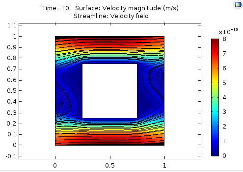

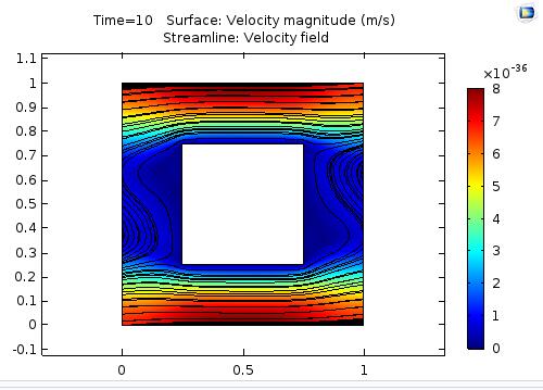

The problems I have met are as follows.
1) Using PDE equations, if I adopted the stationary solutions as the initial values for the time-dependent sovler, the obtained transient results will just the same as the steady ones, even for a very large Re number;
2) I have tried the built-in laminary flow interface. But the results strongly depend on the initial values as shown in the attachment (the initial value for u is 1e-2, 1e-20 separately at Re=10); since I run a large range for Re and the geometry is quite complex, which make it impossible to calculate the initial values at the corresponding Re.
3) As for the "flow past a cylinder" model, it defines a "step1" to trigger the disturbance at the inlet boundary; while I used the periodic boundary conditions, thus the only place to use "step1" is at the initial values setting windows, which will mix the problem (2) about determining the initial values.

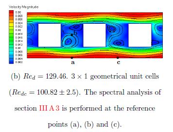

The expected result can be seen in the reference(attachment).
Is there something wrong about my settings? or should I add a perturbation to induce the unsteady flow, as in www.cfd-online.com/Forums/main/135769-time-dependent-solver-unsteady-navier-stokes.html
