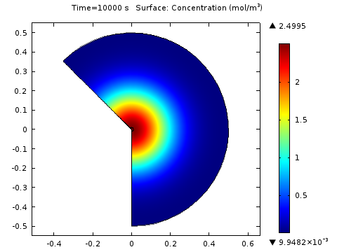

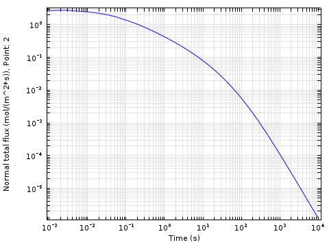

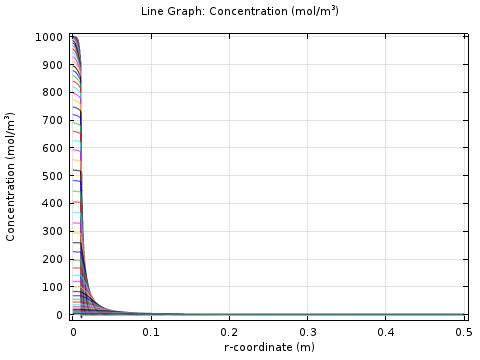

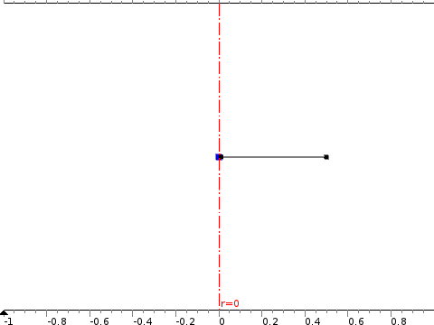

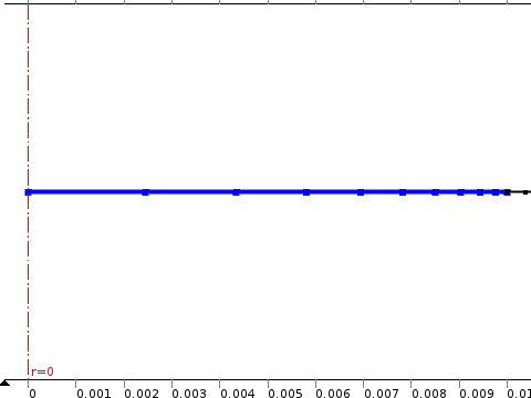

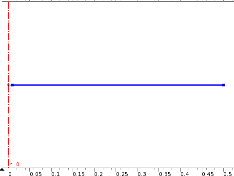

Posted: 1 decade ago 07.08.2014, 12:16 MESZ
You have to define an explicit value for the initial concentration. It can be also time-dependent, but it cannot be a free variable.

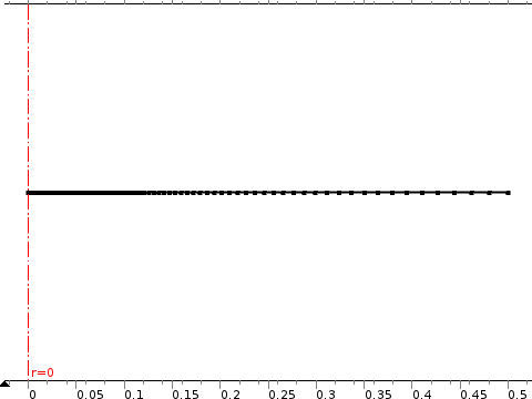

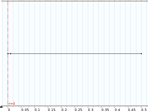

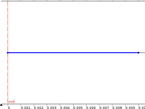

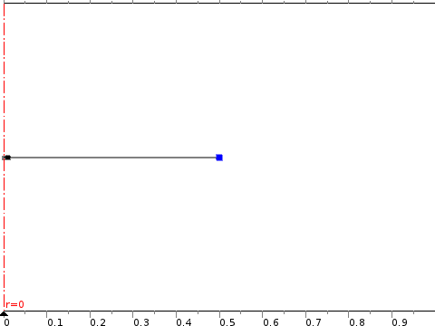

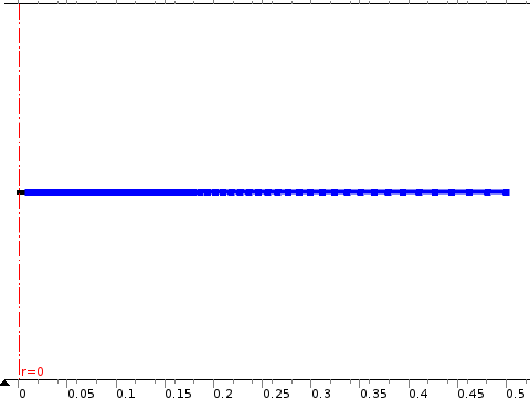

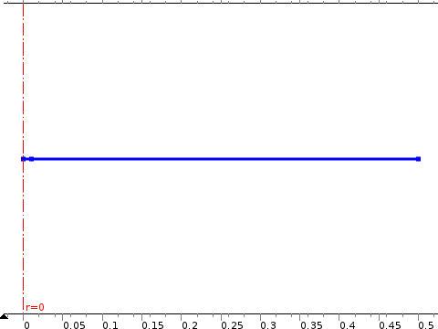

Your geometry is such that a 3D model is not needed. I made an axisymmetric 1D model for you, attached. I use version 4.4, I wish you can open it.
Also some figures from the model report are attached.
BR
Lasse
