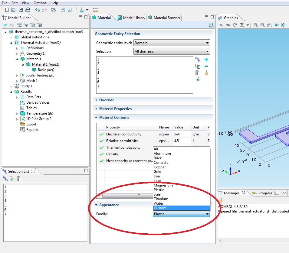

Hi Sebastien,
Once a material was added to the model, you can go to the bottom of its properties and find the Appearance options (see the screenshot).
Best Regards,
Dima.

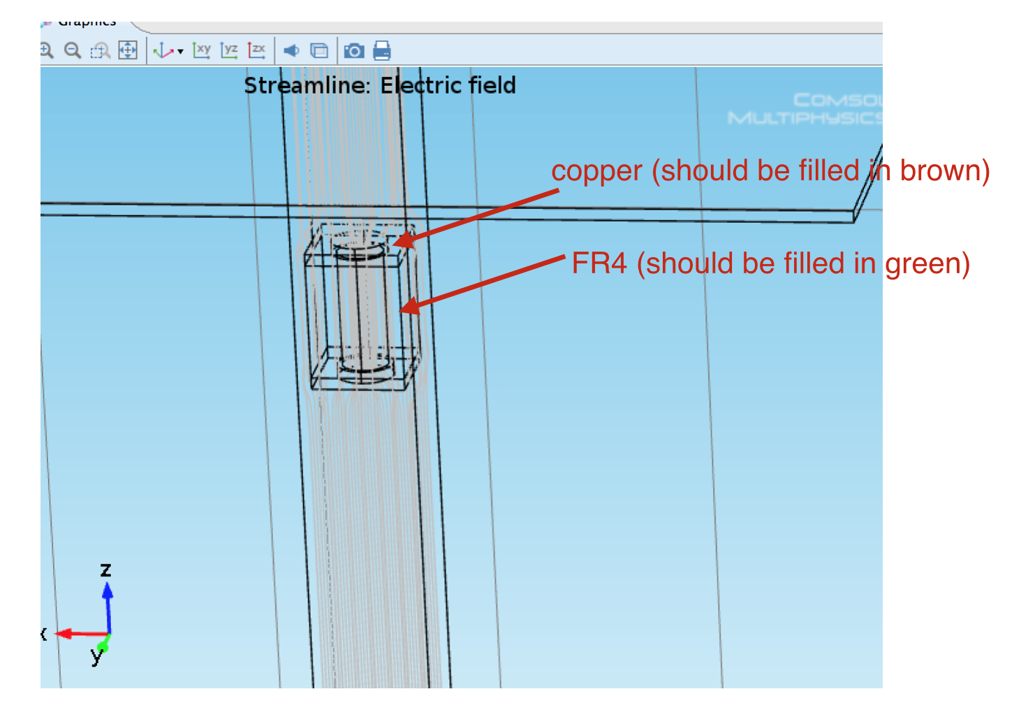

Posted: 1 decade ago 14.08.2014, 09:19 MESZ
thanks for you answer. ok this is done but I cannot have the objects displayed and filled with the colours when plotting eg streamlines or a result of a computation (actually I can never manage to display with colours). See screenshot.
Cheers,
Sebastien
Hi, thanks for you answer. ok this is done but I cannot have the objects displayed and filled with the colours when plotting eg streamlines or a result of a computation (actually I can never manage to display with colours). See screenshot. Cheers, Sebastien

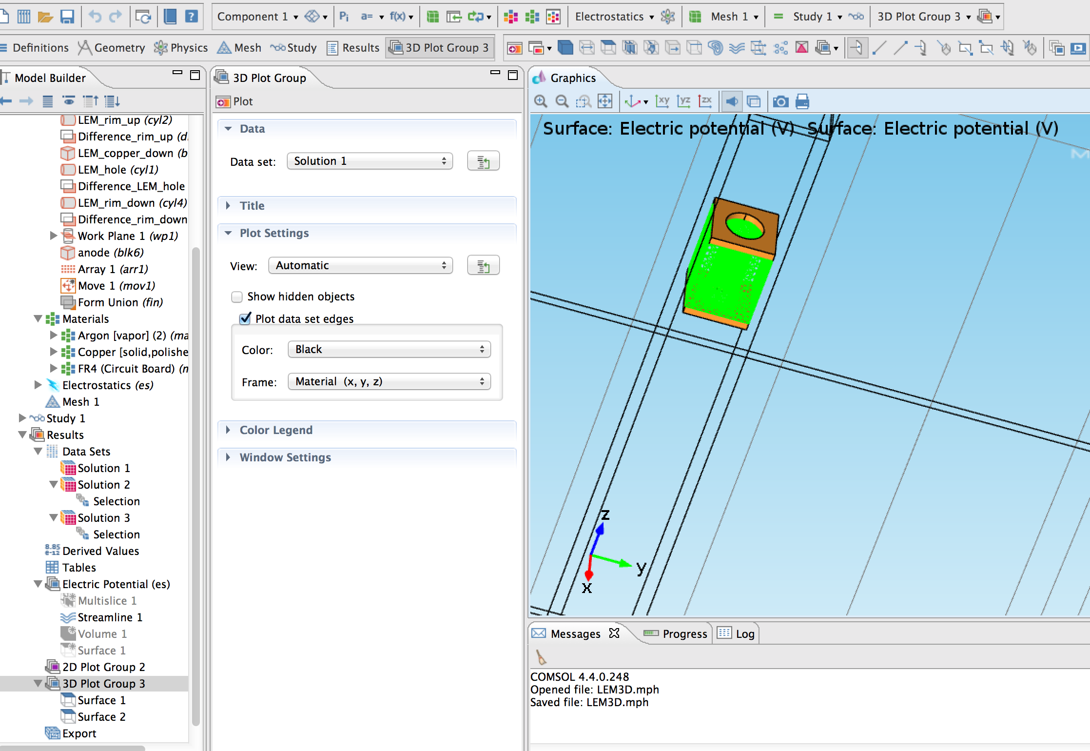

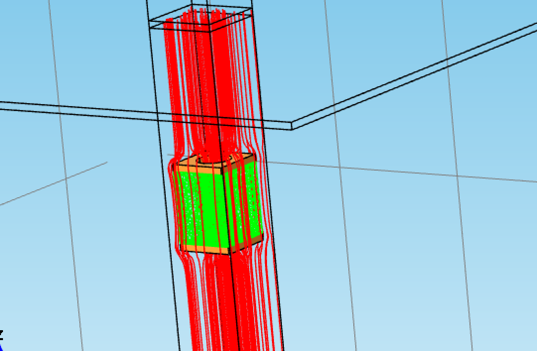

Posted: 1 decade ago 14.08.2014, 10:11 MESZ
ok getting there (see screenshot). But I cannot superimpose with streamlines. When I click on streamline the colours disappear and it goes back to transparent.
Just another general question. This method is a kind of workaround, there is then no way to use the colours I assigned to the materials for the solutions. Is there a way to actually display the material with its assigned colours even without superimposing the solutions. In other words what is the use of having material colours?
Thanks,
Sebastien
Hi, ok getting there (see screenshot). But I cannot superimpose with streamlines. When I click on streamline the colours disappear and it goes back to transparent. Just another general question. This method is a kind of workaround, there is then no way to use the colours I assigned to the materials for the solutions. Is there a way to actually display the material with its assigned colours even without superimposing the solutions. In other words what is the use of having material colours? Thanks, Sebastien
Posted: 1 decade ago 14.08.2014, 10:20 MESZ
This is the only method i know. Hopefully someone will show us another one.
Plot both the streamlines and the surface plot under the same 3D plot group. Probably it will solve the problem.
