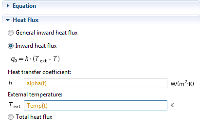

Posted: 1 decade ago 19.08.2014, 05:24 MESZ
Hello, Frank!
Very much for your answer!
Could you tell how much this value (ratio of specific heats) for water? I take is 1 - this is correct?
Thanks, I will be trying various value mesh. (my problem temperatures range from -5 to +60 [degC]).
It did you mean? (see pict.) But this dont work.
Alexey
Hello, Frank! Very much for your answer! Could you tell how much this value (ratio of specific heats) for water? I take is 1 - this is correct? Thanks, I will be trying various value mesh. (my problem temperatures range from -5 to +60 [degC]). It did you mean? (see pict.) But this dont work. Best regards, Alexey
Frank van Gool COMSOL Employee
Posted: 1 decade ago 19.08.2014, 11:32 MESZ
Dear Alexander,
For ice to water you can use 1 indeed.
Regarding your screenshot, you need to specify the functions under definitions before you can use them. As you did not include your whole model, I have no way of seeing what you did there.
Please add the model so I can see what is happening there.
best regards,
Frank
Dear Alexander, For ice to water you can use 1 indeed. Regarding your screenshot, you need to specify the functions under definitions before you can use them. As you did not include your whole model, I have no way of seeing what you did there. Please add the model so I can see what is happening there. best regards, Frank

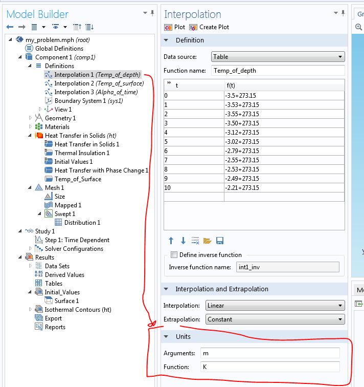

Posted: 1 decade ago 19.08.2014, 17:28 MESZ
Dear Frank,
This is my model, please, see it. yadi.sk/d/nRRxBU_-a4BSH
Best regard,
Andy
Dear Frank, This is my model, please, see it. https://yadi.sk/d/nRRxBU_-a4BSH Best regard, Andy
Posted: 1 decade ago 20.08.2014, 09:26 MESZ
Dear Andy,
I notice that you only got a warning (yellow) for the functions because of the units that were inconsistent. You can usually ignore that, but I attached your file where I fixed it for you.
Under the functions, you can fill in the units of the arguments and the function itself.
Note that you can also specify that the output is in degC, and then you can skip the +273.15.
Furthermore I slightly adjusted your mesh to better follow the changes in the time.
And I set the interpolation of the functions to "piecewise cubuc", this smoothens out the function so the derivative is continuous as well.
Good luck with your model.
Frank
Dear Andy, I notice that you only got a warning (yellow) for the functions because of the units that were inconsistent. You can usually ignore that, but I attached your file where I fixed it for you. Under the functions, you can fill in the units of the arguments and the function itself. Note that you can also specify that the output is in degC, and then you can skip the +273.15. Furthermore I slightly adjusted your mesh to better follow the changes in the time. And I set the interpolation of the functions to "piecewise cubuc", this smoothens out the function so the derivative is continuous as well. Good luck with your model. Best regards, Frank
