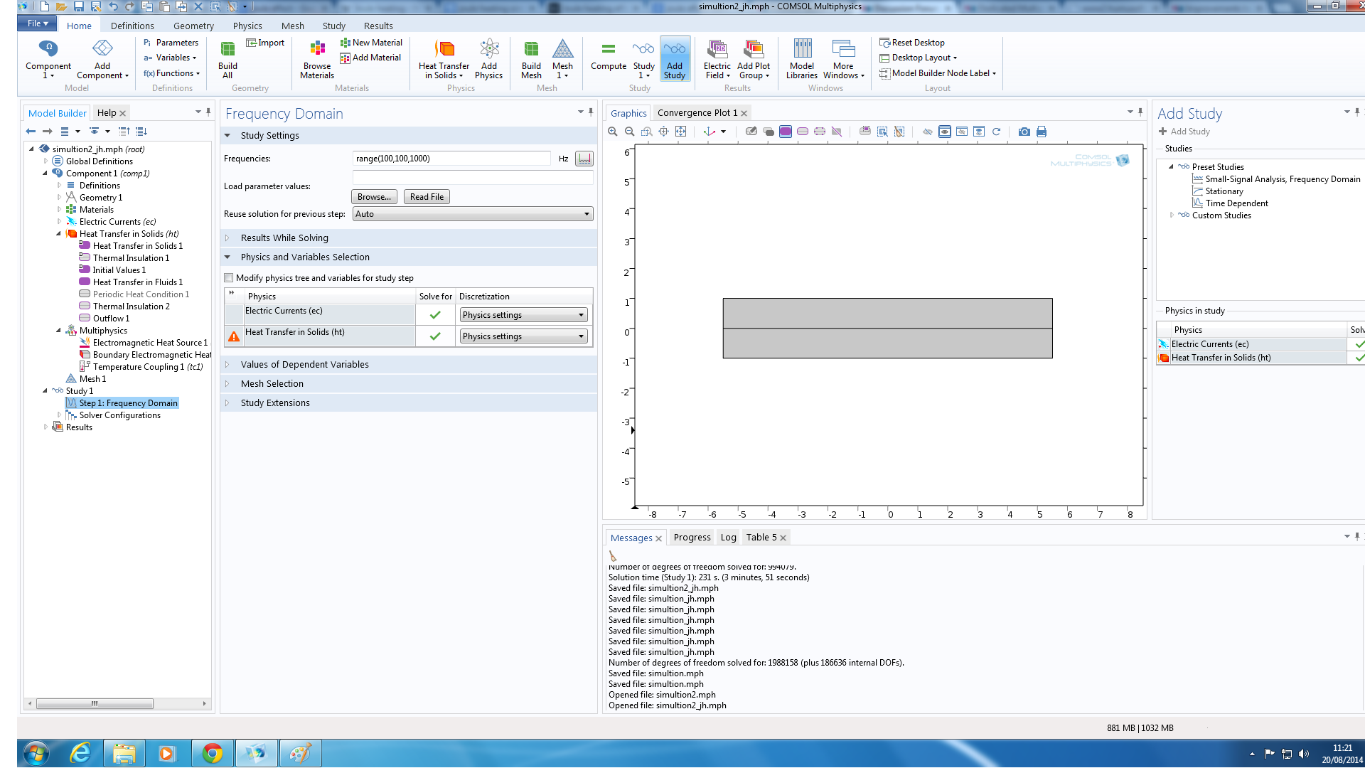

I have started working with Comsol recently and I have been trying to create a model like this: four electrodes in a suspending medium (the model is based in salty water), on a glass surface.
The aim is to create a travelling wave signal so a sinusoidal signal with different phase is applied to each electrode.
I have tried to visualize the temperature after performing a frequency dependent study, but the temperature does not change. Any suggestion to this problem?

Now I am sending my model.
I also realized that I can't perform a frequency domain study for the Joule Heating Module.
There is a warning signal next to it, as you can see from the screenshot I got.
Thanks.
