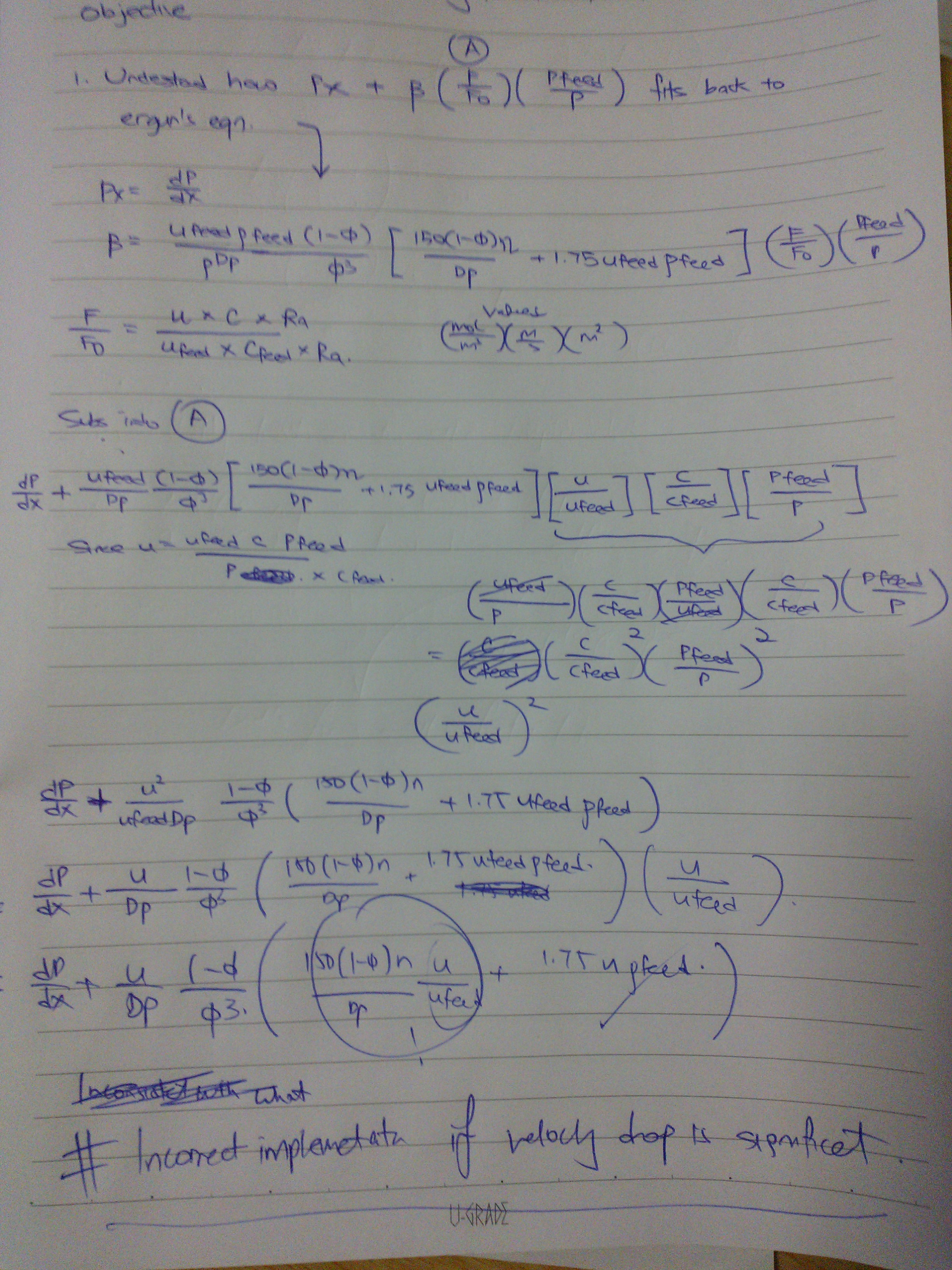

I was trying to figure out how Ergun's equation was implemented into the model, and I did some reverse-engineering from this file. However, I found that the implementation was mathematically-incorrect, and this is even more so if the velocity drop across the packed-bed was significant.
I've attached my proof. Hope that someone who's also invested in Packed-Bed reactors can comment.

Hi Wu,
we checked our derivation once more and it seems to be correct. Make sure you have the latest version (5.0) of the model and documentation.
Looking at your derivation, you add the feed rate, u_feed, into the differential equation, when it should be u. That essentially means that you only solve the equation at the inlet.
