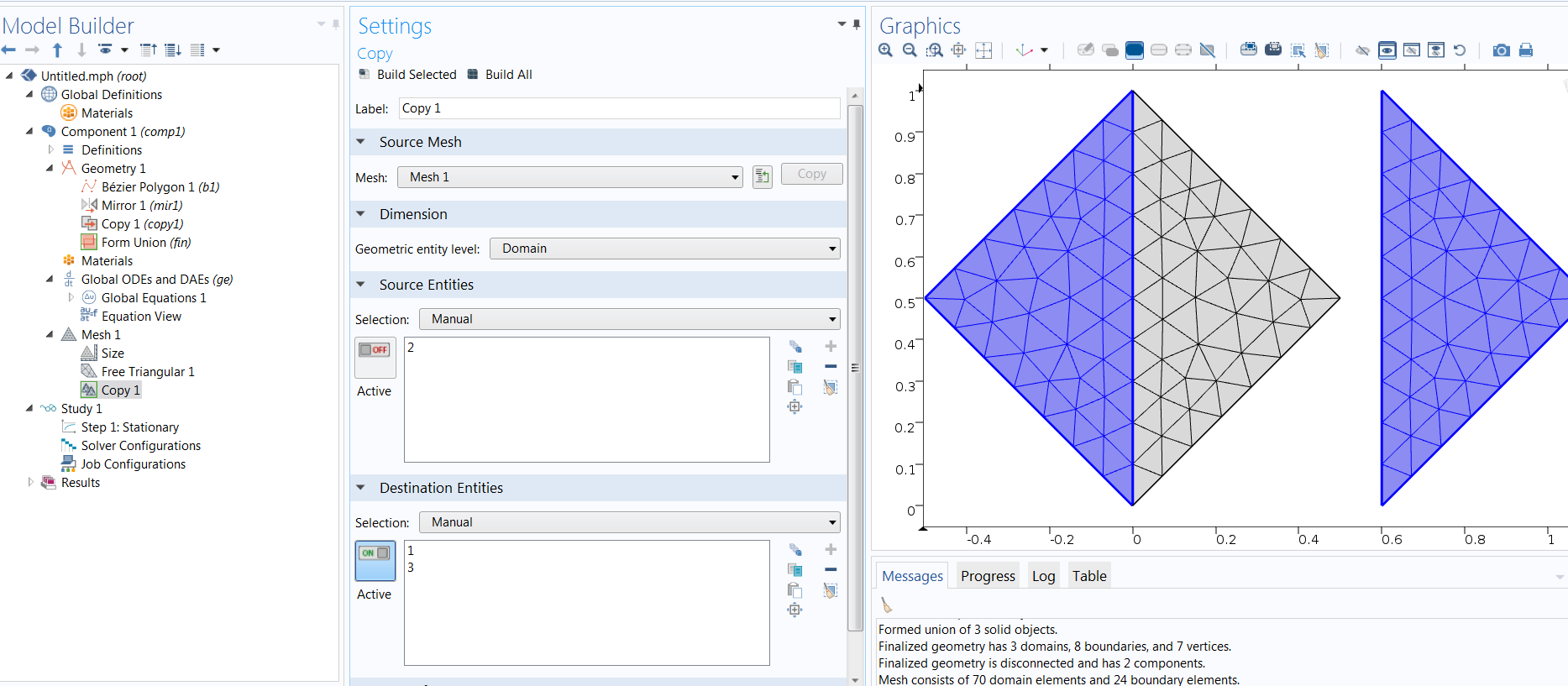

Hey Ivar
I read a lot of your discussions about symmetrical meshing. Do you know if they already built a "mirror mesh" operation? I only found "Copy Domain" and "Copy" in the mesh subnotes. But these two operations do not really solve the problem for mirroring a mesh.
Do you know anything new? Or do you still work with splitting the geometry and "copy mesh" on edges, etc...?

Posted: 1 decade ago 02.11.2015, 13:54 GMT-5
Normally if your part is symmetric the "copy mesh" will automatically detect this and make a symmetric copy hence you get your mirror operation, but I'm not sure if it's capable of a central symmetric mesh operation.
Try it out with a "sand case/toy-model"
