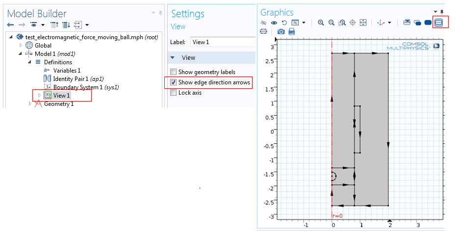

1. The orange color you in the Global Equations settings window is not because the units are wrong but because the units for the global variable “Ub” are not specified at all. If you specify units of length (m) for the Dependent variable quantity Ub and appropriate units for the Source term quantity the color becomes black as shown in the first attached image.
2. Comsol uses internal variable “s” for the Arc length parameter. Parameter s=0 at the beginning of any arc and s=1 at the end of the arc. You can see this by creating 1D Plot Group/Line Graph, then select any edge and type “s” as Expression for the y-Axis Data. Also, you can visualize the direction of edges by checking box “Show edge direction arrows” in the View node, as shown in the second attached image.
Sergei

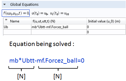

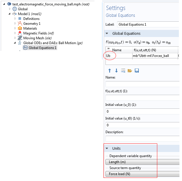

Dear Sergei,
thank you for your notes.
I think: (@ Definitionen -> Variables1)
Uz = t * 1[m/s] * 0 + Ub
*with the units [m] = [s] * [m/s] * [ ] + [m]
is correct and (@ Global ODEs and DAEs: Ball Motion -> Global Equations 1)
Ub = mb * Ubtt - Mf.Forcez.Ball
*with the units [m] = [kg] * [m/(s^2)] - [N]
unfortunately, this is not correct, Ub should also have the unit [N] ?
But Comsol shows no Error, why? Where did I make a mistake?
With best regards, Thomas
Dear Sergei, thank you for your notes. I think: (@ Definitionen -> Variables1) Uz = t * 1[m/s] * 0 + Ub *with the units [m] = [s] * [m/s] * [ ] + [m] is correct and (@ Global ODEs and DAEs: Ball Motion -> Global Equations 1) Ub = mb * Ubtt - Mf.Forcez.Ball *with the units [m] = [kg] * [m/(s^2)] - [N] unfortunately, this is not correct, Ub should also have the unit [N] ? But Comsol shows no Error, why? Where did I make a mistake? With best regards, Thomas
Posted: 1 decade ago 23.10.2014, 06:44 MESZ
Thomas,
The first column in the setting window for Global equations is the name of the variable being solved for, i.e. you are solving for variable Ub.
The second column is for declaration of the Left Hand Side of equation you are solving, i.e. LHS=mb*Ubtt-mf.Forcez_ball
The actual equation you are solving is as following:
LHS=0
or
mb*Ubtt-mf.Forcez_ball=0
Both terms of this equation have the same units of force [N]. So, units are consistent and correct, see attached image.
Sergei
