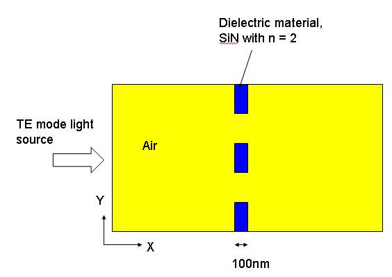

                                                    left: add PML(x), and use scattering boundary condition with a source
right: add PML(x), and use scattering boundary condition without a source
top and bottom: PMC
simulation domain: 10 um is enough
Wenshan
top and bottom: PMC
Wenshan

                                                    Hi Wenshan,
I am solving a similar problem and your comments were helpful. I was wondering how do you add both a scattering boundary condition and a port source at the same boundary. Or did you mean define the scattering boundary condition with a source such as a plane wave?

                                                    Hi Wenshan,
I happen to read the reply, I was wondering how to set the "left: add PML(x), and use scattering boundary condition with a source". Could you please tell me?

                                                    Although Wenshan might be able to clarify, until 3.5a it was impossible to have scattering boundaries in the interiors of geoemtry

I have seen in a paper, they created a domain (not a interior boundary) inside the geometry  just beyond one of the PMLs (there are two PMLs in one direction just like the model here), and set this domain as a source to excite the whole calculation domain. I really have no idea how they did this.They did not mention how they did this. Do you have any idea how to do this? or do you know how to add a plane wave source in the interior of a geometry which we can change the incident angle?

                                                    I know you cannot have practical excitation sources in the interiors of geometry. The most you can have is to specify the electric/magnetic field values in interior boundaries. But that doesn't allow back reflected waves because the field values are fixed which is rarely what you want in your simulations.
And I have no idea about subdomain sources though it shall be interesting to see.
