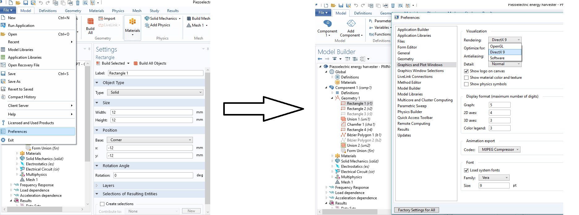

I found a solution:
On the prefrences, I changed the graphic software from OpenGL to Direct9X.
I found a solution: On the prefrences, I changed the graphic software from OpenGL to Direct9X.

The problem can also be solved for 5.0 by that changing. Great! Many thanks to Ron.

Just follow the instructions below as Ron Lira mentioned

Thank you changing the graphics software from openGL to DirectX works.
