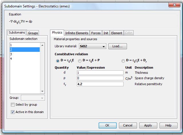

what does 'thickness' in electrostatics subdomain setting stand for?
when I edit sub domain property, there are three quantities:
thickness (d)
space charge density
and relative dielectric constant
What's this thickness?
Attached is the screen shot
Thanks!

I assume you are in 2D mode, then the "thickness" is the extend of your model in the "out of plane" direction, this is related to certain variables such as a density given in kg/m^3 and that need a thickness value (3rd dimension) to calculate correctly, or more related to electrostatics alone : a space charge C defined in C/m^3.
Normally COMSOl is working coherently in 3D but gives you the possibility to work in 2D by fixing one direction through the "thickness" value,
In the same way, in 2D axisymmtry, to calcualte a volume you must multiply by 2*pi*r the corresponding "thickness" for an aximsymmetric case
hope this helps (and that my interpretation is fully correct)

Yes I agree with that,
The thickness is activated only in 2D mode. There is no thickness parameter for 3D or 2D axial symmetry.
You can notice that the thickness (d) is multiplied to the volume charge density (rho), this gives you somehow a surface charge density in your model.

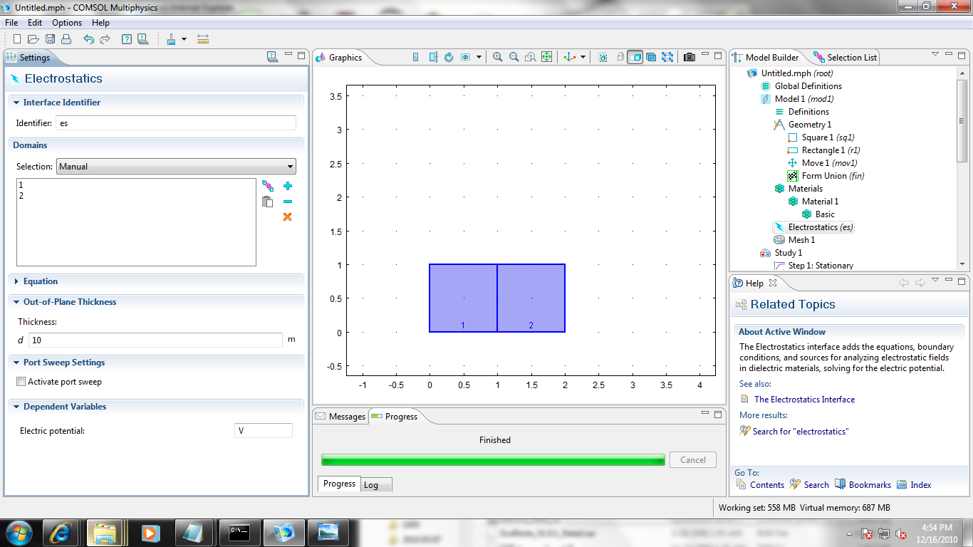

Hi:
I am using 4.0, and I could not specify differnet regions with different thickness(though I do know how to perform this task with version 3.5.. ) Could some please help me with this simple question? Thanks!

In version 4, it is no longer possible to set the thickness per subdomain in 2D electrostatics and electric currents. You can set a thickness parameter for the entire physics inter face on the physics interface node.
A possible workaround is to multiply the permittivity by a domain specific thickness factor.
It makes sense to use a domain specific thickness in stationary electric currents as the current may well be confined within the thickness of a slab (surrounded by a non conducting medium). For electrostatics and high frequency electric currents modeling it is more questionable as the electric displacement is never that well confined. Dielectric contrast is rarely more than an order of magnitude.
The main reason it has not been implemented in version 4 is that we thought it may encourage the less experienced user to apply a questionable approximation.
