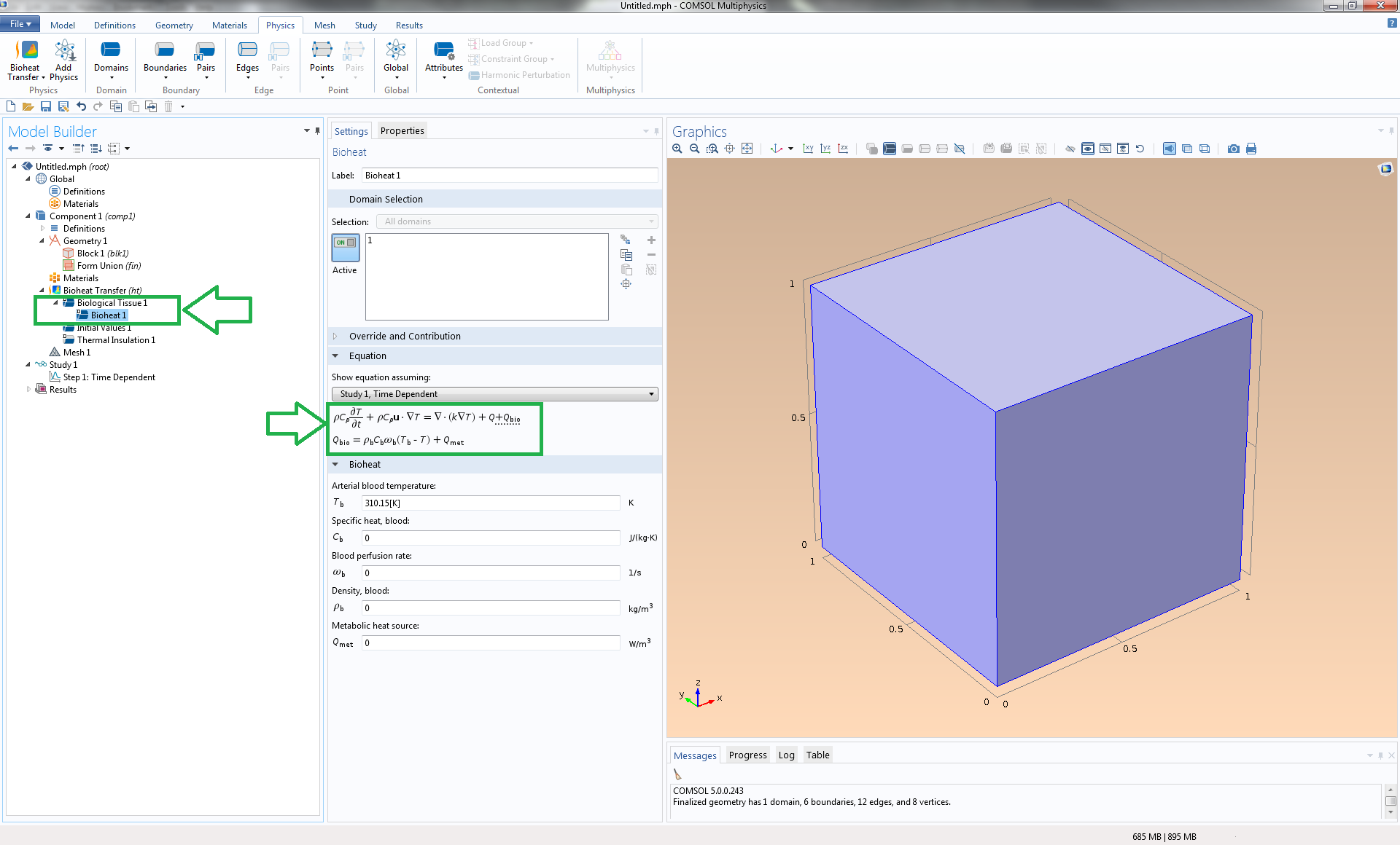

Can anybody tell me how to calculate this equation?
the term containing the laplace operator is =0 under steady state conditions?

Pennes equation is implemented in the Heat Transfer Module, see attached screenshot.
To determine if your license includes the HEat Transfer Module, go to File>Licensed and Used Products.
Hello, Pennes equation is implemented in the Heat Transfer Module, see attached screenshot. To determine if your license includes the HEat Transfer Module, go to File>Licensed and Used Products. Best, Jeff
