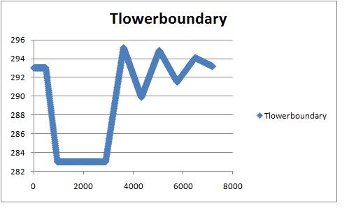

Maurits Vandegehuchte
Posted: 1 decade ago 24.11.2010, 05:58 GMT-5
If I use following function in the boundary expression:
293-10*flc2hs(t,0)*(600<t)+10*flc2hs(t,0)*(3600<t)
the resulting temperature at this boundary makes a nice step between 600 and 3600 s, but afterwards it starts to oscillate (while it should remain constant at 293) (see figure)
Any tips?
If I use following function in the boundary expression: 293-10*flc2hs(t,0)*(600
Posted: 1 decade ago 24.11.2010, 08:40 GMT-5
I can only think of two reasons for "oscillations":
i) your BC is oscillating, but you should be able to plot that function (or define it as a function first and then plot it from the user function menu)
ii) you have some numerical or strange model issues going on, ad one coul expect that to happen also if you sart with just one step
cannot suggest more like taht ;)
