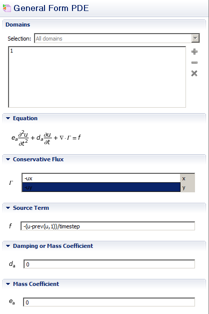

On the picture
general_form_input.png below you'll see how to enter the following equation:
(u^{k+1} - u^k)/dt - div(grad(u^{k+1}) = 0
By setting
f to
-(u-prev(u,1))/timestep in the PDE General form interface.

On the picture [b]general_form_input.png[/b] below you'll see how to enter the following equation:
By setting [b]f[/b] to [b]-(u-prev(u,1))/timestep[/b] in the PDE General form interface.

On the picture general_form_input.png below you'll see how to enter the following equation:
By setting f to -(u-prev(u,1))/timestep in the PDE General form interface.
