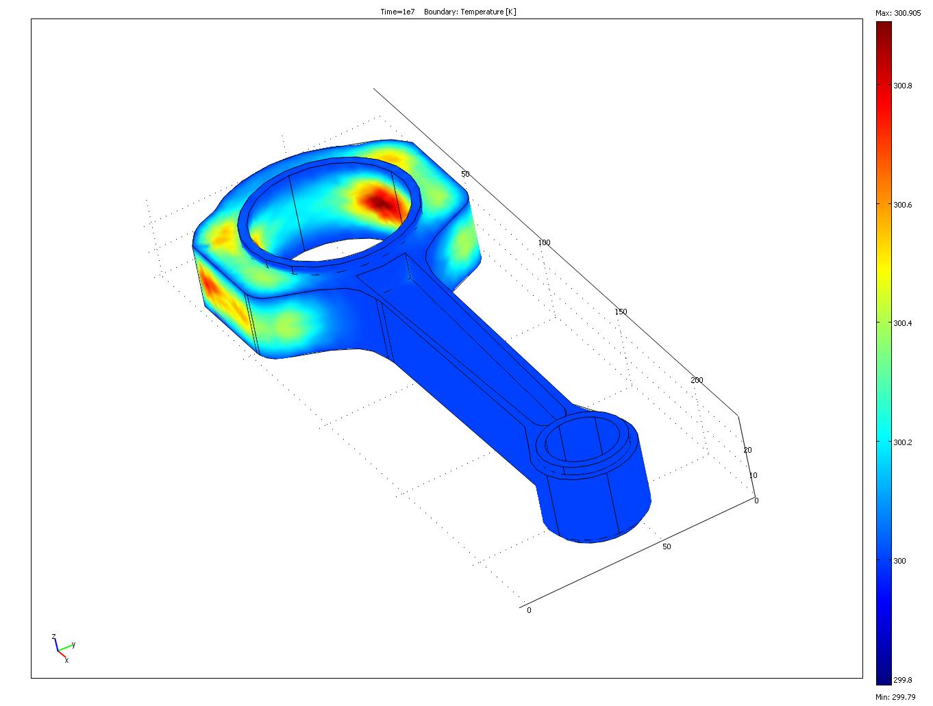

So after running the simulation, it takes a long time for the model to cool to room temperature. Example would be setting the time to 1*10^7 seconds. The exterior of the rod would be at room temperature, but a slice plot shows certain internal areas to be still at around 1800-2000K. This occurs around the areas where the two large holes are for a connecting rod. Even at lower time intervals, such as 1 hour, the max temperature actually rose higher.
As a test, I ran a simulation for a simple 3-D cube with comsol library material properties for AISI 4340 with constant properties. The plot still shows that the internal temperature is much higher the exterior after running with a large time interval. The cooling time just does not make sense.
Some advice that was given to me was to impose q for the boundary conditions.
As an example of what I am working with, I have attached a temperature distribution of the rod with a time scaling coefficient of 1/60. Note the the time at the top of the graph and temperature scale on the right. I don't have access to comsol at the moment, so I can't get a sliced view.

Not in front of comsol at the moment, but I'm pretty sure I figured out the problem. UNITS
I modeled the rod in solidworks CAD program and exported the file to an stl. I exported the file in milimeters and comsol is defaulted to meters. Therefore my model had a scale that was up to 216 m long. That explains why it was taking so long to cool.
