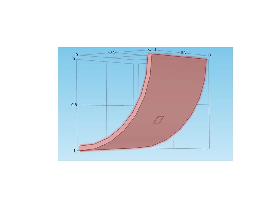

This is not very elegant, but will this do? If you don't have version 5.0, this is the procedure:
1. Create a hollow cylinder and cut it with, e.g. blocks to a desired shape.
2. Draw another block across this tubular wall.
3. Partition the last block.
4. Convert this partition to curves.
5. Remove extra edges.

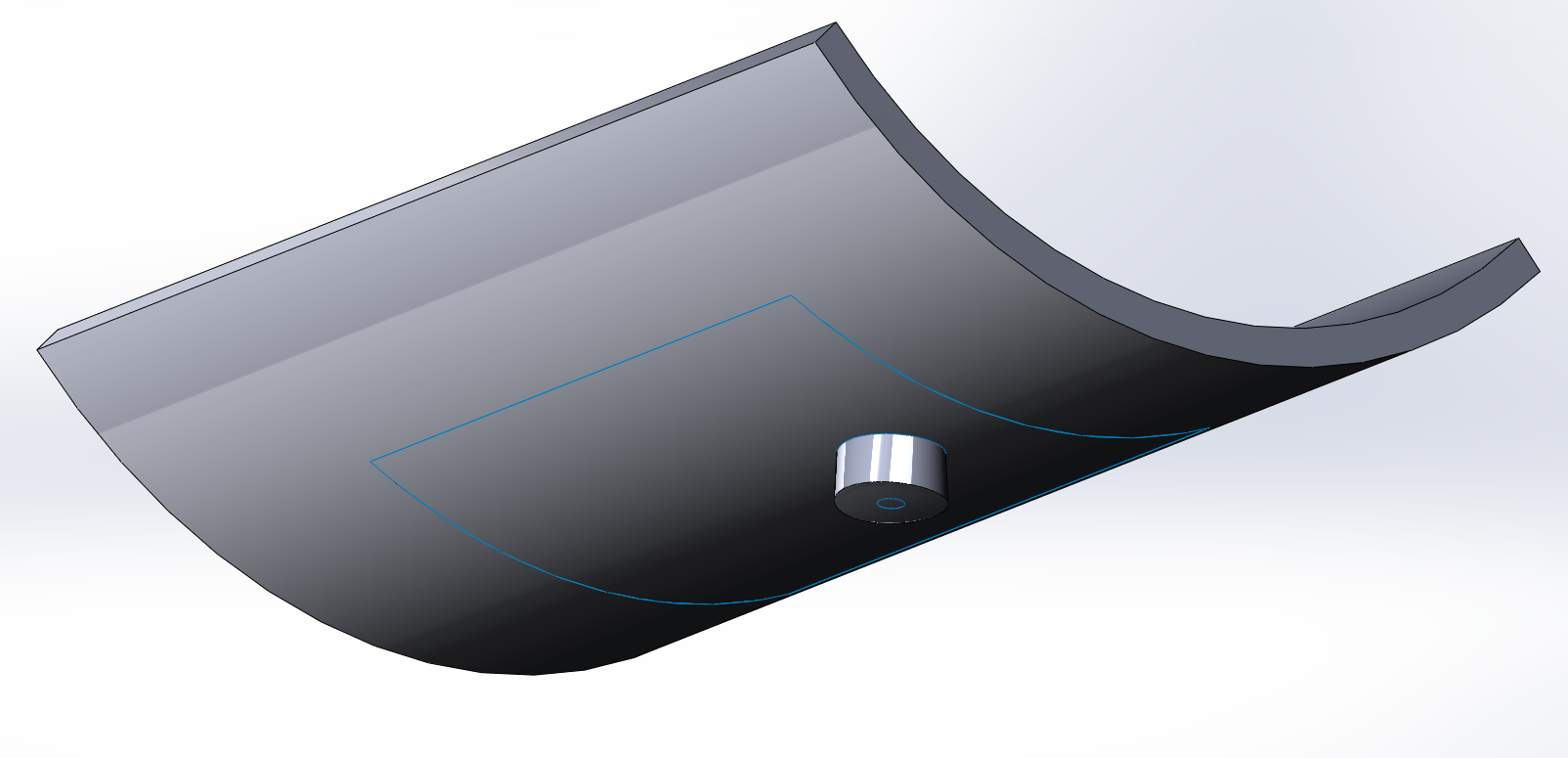

Thank you very much for your help. Actually I have already tried what you mentioned however I have stuck when I was trying to draw mounted concentric cylinders which are mounted on the concave surface. Do you have any idea if I can draw those cylinders too?

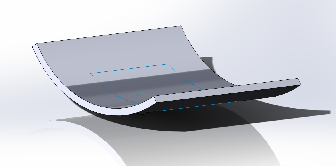

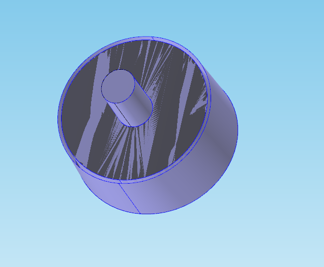

Thank you very much for your advise. I have already tried to Import my CAD file as well. However I have got some geometry issues. So my simulation didn't work properly. I think the attachment explains my problem much better.
Do you have any suggestion for this problem?
Thank you.
