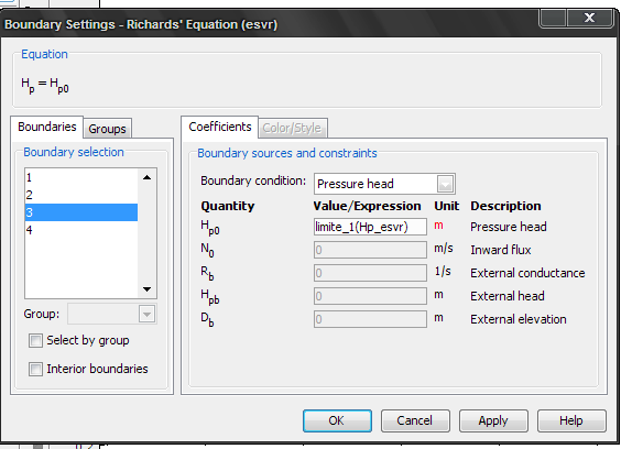

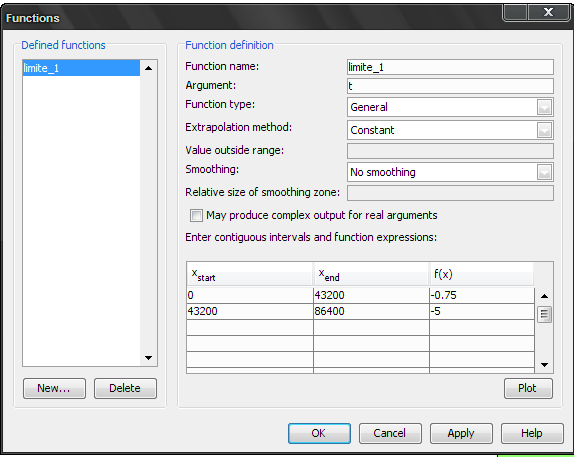

This is what I have done but that does not give a results. help me please.
www.4shared.com/rar/WD2n0TMmba/test.html
[QUOTE] Look at http://www.comsol.com/community/forums/general/thread/58461/ Lasse [/QUOTE] thank you This is what I have done but that does not give a results. help me please. http://www.4shared.com/rar/WD2n0TMmba/test.html
[QUOTE] Hi The link you gave leads to a website which asks to install a software. I won't do that. br Lasse [/QUOTE] sorry This is what I have done but that does not give a results.

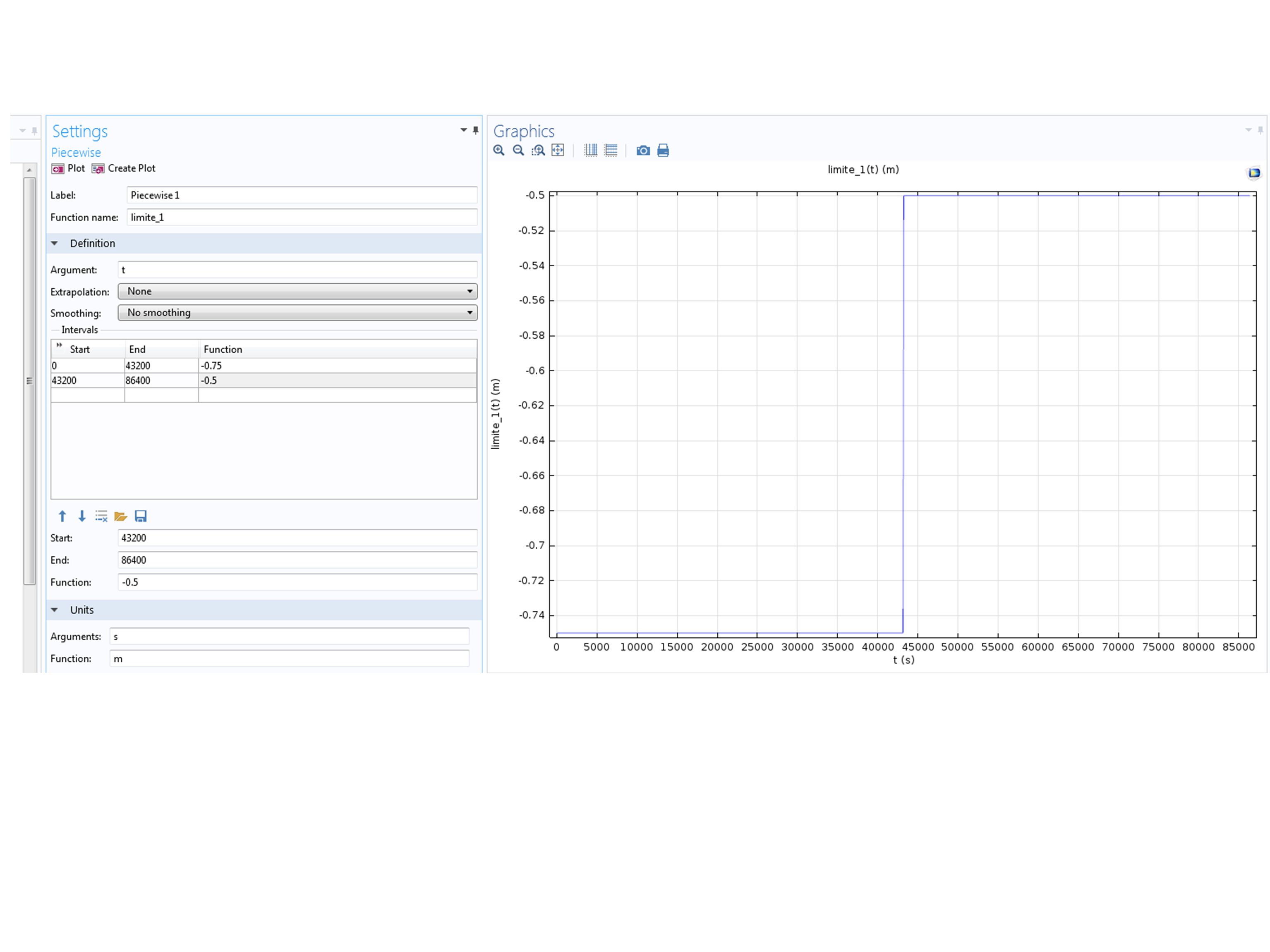

Posted: 1 decade ago 25.02.2015, 15:08 MEZ
Have you defined the units of the argument (t in your case) and the function? See attachment. Function is piecewise.
br
Lasse
Have you defined the units of the argument (t in your case) and the function? See attachment. Function is piecewise. br Lasse
