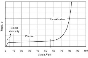

I'm trying to implement Ogden's model for polyurethane elastic foams into COMSOL. Currently, I'm working with the structural mechanics module and trying to model the uniaxial compression stress-strain response of these foams. The tend to behave in a non-linear fashion and a typical stress-strain curve is attached herewith. As I'm new to COMSOL, can anyone suggest how to change the governing equations and boundary conditions and preferably some tutorial on the equation modification process.

I believe you could start with entering the non linear curve into your material properties (ie. make a custom material), I would also suggest to start with an isotropic material (even if wrong) and when your happy with your model , only then make it anisotropic.
I do not think you need to change anything else. In fact, you do not even need to make a "custom material", you can start to define your "function" and type it straight into the subdomain material properties, but for later its usefull to enter as a custom material.

Thanks for your efforts in replying. Yeah I will try to work in the way as you suggested. Actually, my material in not anisotrpic, but it behaves non-linear in any direction of load invariably.

certainly if you have only the basic Comsol Muliphysics, or you do want to implement everything from the bare equations you can start this way, you will certainly learn a lot.
But if I had to reply, I would use the solid structural module, import/create your geometry, define the material variables on the subdomains (and for you define a function based on the material non-linear shape with corresponding comsol I/O variables), define the load/fixed etc BCs and run a solve.
but I beleve you must use the detailed matrices for the material properties as you will not have standard E and nu expressed in a simple form, but if your material is isotropic, you should not have too many items to fill in.
Really you should read through the doc, I know its long, (we have all passed by there) but it's worth it to be far quicker te next time.
Unfortunately, I do not have time to set up a full model for you (I'm a user as you, and just now sitting in a teleconf meeting, but pls do not say ;)
Take i.e. the rubber large deformation case from the model library, there are also several examples in the doc

I am not familiar with foam modeling, but I have been working on implementing ogden model in Comsol 3.5a.
I succeed in 2D, but 3D sometimes it works and sometimes doesn't.
The way I did was go modify the strain energy function in the menu 'physics-Equation system system-subdomain setting' to be the ogden energy function.
But since in the function, we have to calculate the eigenvalues of the strain tensor, then we need to define some global expressions there and define the ogden energy function.
