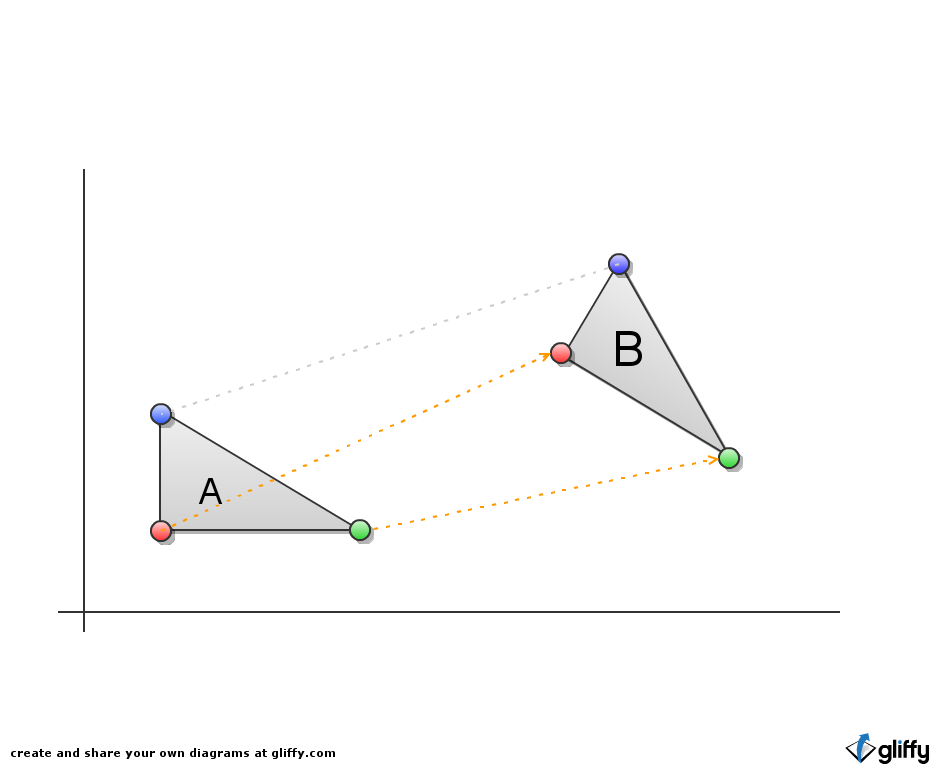

Many thanks for your reply. Actually, my case is a bit simpler.
I have 3 mesh nodes creating 1 triangular mesh element. Now, it rotates - due to boundary moving - and I want to have the coordinate of the last vertex.
In the picture below, I know the coordinates of the triangle A. Now, after rotation I know the coordinates of blue and red points in triangle B, but I don't know the blue point coordinate in B. I want to find out the blue points' displacement in ALE coordinates.
Hi Ivar, Many thanks for your reply. Actually, my case is a bit simpler. I have 3 mesh nodes creating 1 triangular mesh element. Now, it rotates - due to boundary moving - and I want to have the coordinate of the last vertex. In the picture below, I know the coordinates of the triangle A. Now, after rotation I know the coordinates of blue and red points in triangle B, but I don't know the blue point coordinate in B. I want to find out the blue points' displacement in ALE coordinates.

Hi Ivar,
I am not an expert in mathematics, so please bear with me.
A better diagram: www.gliffy.com/pubdoc/2138013/L.png
I was thinking that if I can find the transformation matrix of the bottom of the triangle A (blue line, 1-2) to the blue line in B (blue line, 1'-2'), I can apply it to all other sides and find my desired coordinate (3'). The two triangles move and change size as well, making it bit more tricky; the coordinates in the picture are representative.
So far, I am stuck at transformation, translation and rotation matrices.
Hi Ivar, I am not an expert in mathematics, so please bear with me. A better diagram: http://www.gliffy.com/pubdoc/2138013/L.png I was thinking that if I can find the transformation matrix of the bottom of the triangle A (blue line, 1-2) to the blue line in B (blue line, 1'-2'), I can apply it to all other sides and find my desired coordinate (3'). The two triangles move and change size as well, making it bit more tricky; the coordinates in the picture are representative. So far, I am stuck at transformation, translation and rotation matrices.
