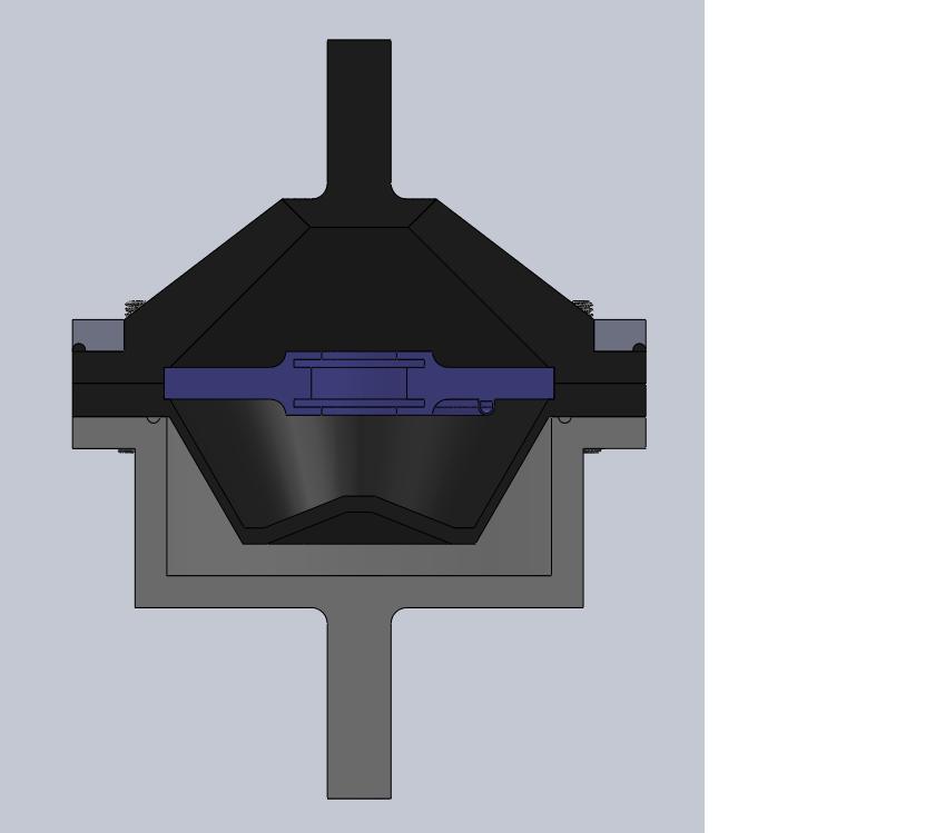

The fluid is contained by two rubber volumes and separated by a metal middle piece and I am trying to examine the damping and stiffness of the mount. Attached is a pic of a (quickly drawn) typical hydraulic mount. The black is rubber and the silver and purple are metal. The upper and lower chambers are filled with incompressible fluid. I am trying to examine how the rubber deforms partnered with the reaction forces back from the fluid. Thank you for your help, does this still seem over-constrained or do you have any additional ideas?
