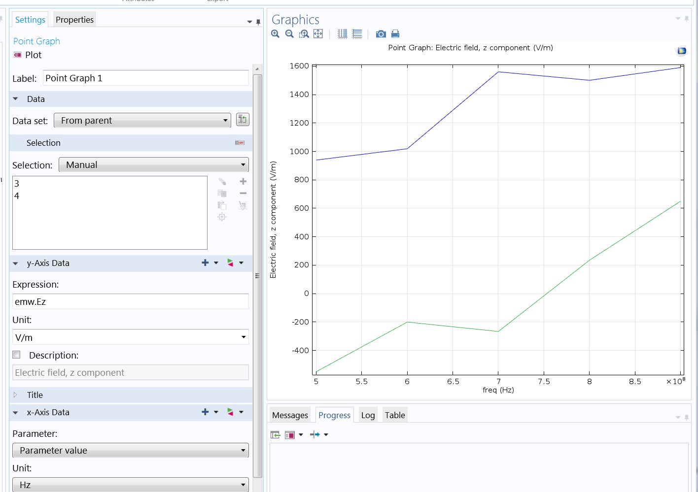

If you have more than one geometric point in your problem, you can load more than one point. Just select the second point the same way you selected the first one. I've attached a piece of a screen-shot that may make this clearer.
