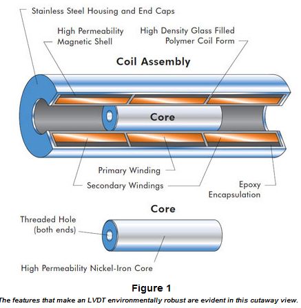

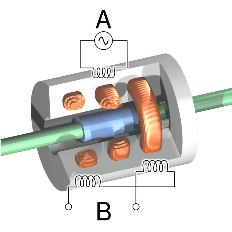

i need ideas and suggestios for Design of LVDT (linear variable Differential Transducer)
i have attached details of LVDT..
Plz kindly give response as soon as possible..
