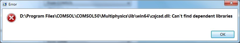

                                                    I would like to second this error.  I am seeing the same thing, and none of my licenses will work unless I go into the Geometry section and select COMSOL Kernel, instead of the CAD import Kernel.  Does this problem have a solution yet?

                                                    I am also this difficulty when I try to import 3D model of the inventor. What is the solution ?

                                                    I'm also experiencing this error message. I intend to try converting the .iam file I was trying to import to an stp file, and then importing that.

                                                    我也碰到了这个问题,我是这样解决的:在文件-首选项-几何中我把几何表示的选项全部改成了comsol内核,之后就好了。但是我在之前的电脑上使用时,都是使用的CAD内核,同样没问题,感觉好奇怪。祝各位好运!
