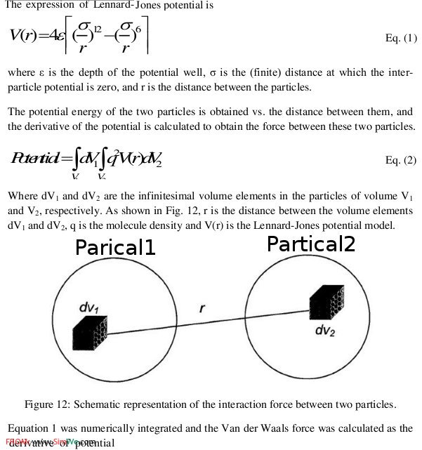

I met a problem on Integration when I use Comsol to calculate Lennard-Jones Potential. I wanna know: in 3D, how to deal with "int_v1(dV1)int_v2(f(r)dV2)", dV1=dx1dy1dz1,dV2= dx2dy2dz2, v1 is subdomain1, v2 is subdomain2 and f(r) is the function of distance of dV1 and dV2, as shown EQ2 in attachment. Should I use PDE fomulation or integration coupling variables?
Thanks a lot!!!!!

have you checked how to use the "dest()" operator on the different source and destination domains ?
I believe this is jut writing out plainvise your integration equation, no ?

Thank you! "dest" seems to be great!
But, one more question, when I use "integration coupling variable" in postprocessing, it appears only one CPU do work, actually I have 8 CPUs and use "-np 8 -64 ", however solving will, as expected, use all 8 CPUs. Is postprocessing can only use one CPU? Is there any way to work around it?
How about use PDE or ODE to tackle my problem?
