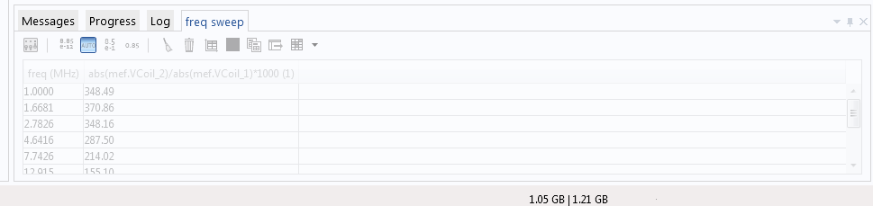

tables grayed out?
I just opened a model in 5.1 and it appears the results tables are completely locked down (can't scroll, copy, etc.). What's that about?

Yes,
Same here.
I produced a report to see the table values until the fix comes along,
Mike
Yes, Same here. I produced a report to see the table values until the fix comes along, Regards, Mike

Ditto.
Well, I see that report icon, guess I get to find out what that does now.
- Mike
Ditto. Well, I see that report icon, guess I get to find out what that does now. - Mike

COMSOL Support have indicated there will be a fix patch for this coming out shortly,
Mike
Hi, COMSOL Support have indicated there will be a fix patch for this coming out shortly, Regards, Mike

This is now corrected in COMSOL 5.1 Update 1. If you have 5.1 installed, you can update it here:
www.comsol.com/product-update/5.1
This is now corrected in COMSOL 5.1 Update 1. If you have 5.1 installed, you can update it here: http://www.comsol.com/product-update/5.1 Best regards, Jeff
