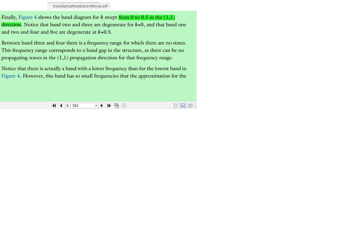

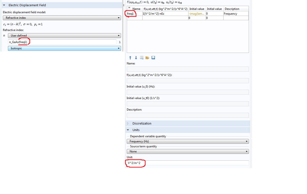

Hi, have you figured out the problem of calculating the bandgap of photonic crystals? I'm also encountering some problems when studying the case of Optical waves "bandgap_photonic_crystal.mph." About the case, I have some questions:
1. the corresponding PDF of bandgap_photonic_crystal.mph says that the refractive index of GaAs is frequency dependent, and the setting of "wave equation, electric 2" gives n_GaAs(freq1), while "freq1" has the dimension of intensity of electric field V^2/m^2, could you explain this?
2. In the sixth page of "WaveOpticsModelLibraryManual.pdf", figure 4 gives the band diagram for k swept from 0 to 0.5 in the (1,1) direction. But i cannot find the corresponding settings standing for the (1,1) direction in bandgap_photonic_crystal.mph. could you tell me where the corresponding settings standing for the (1,1) direction in bandgap_photonic_crystal.mph are? or could you tell me how to figure out the whole band diagram of photonic crystal including Gamma--M--K--Gamma, just like the band diagram given by Rsoft?
3. could you briefly tell me the process of calculating band diagram and equifrequency surface of PhC using Comsol Multiphysics?

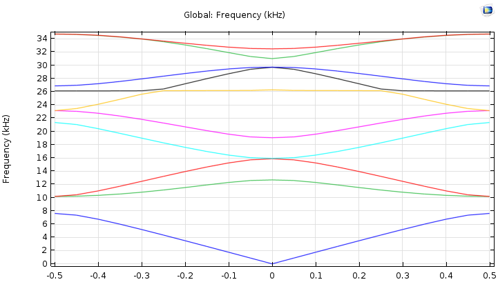

Dear Nagi
really thank you very much i have calculated the band strcture of my system as in the attached figure ...
but i have a problem in the wave vector axis , i want it to take the coordinate (M X) of the first brillion zone ...
also i want to calculate the transmission ..
thank you

Dear Tianjing,
In the COMSOL model you refer to they sweep k from 0 to 0.5 because of the way the kx and ky vectors are defined: there is a factor of 2 in the b1x, b1y, b2x, b2y definitions. In our model we don’t have that factor so have to sweep over k from 0 to 1. Regarding your first question, yes you need to sweep the other 2 sides as well. You can do that in separate analyses or if you want to keep it all in one analysis use the “if” statement to define kx and ky, just like we did in our model.
Nagi Elabbasi
Veryst Engineering
Dear Tianjing, In the COMSOL model you refer to they sweep k from 0 to 0.5 because of the way the kx and ky vectors are defined: there is a factor of 2 in the b1x, b1y, b2x, b2y definitions. In our model we don’t have that factor so have to sweep over k from 0 to 1. Regarding your first question, yes you need to sweep the other 2 sides as well. You can do that in separate analyses or if you want to keep it all in one analysis use the “if” statement to define kx and ky, just like we did in our model. Nagi Elabbasi Veryst Engineering
