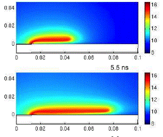

Now, my model converges for atmospheric pressure and with multiple modules. This has allowed me to define my boundary conditions properly. However, comparing my results with computational studies done in the past, my model does does not matches the expected trend. For example: The plasma (indicative by positive ion density) should evolve over the dielectric surface as shown in Fig1, for a positive potential over the exposed electrode. My plasma however does not evolve in this manner.

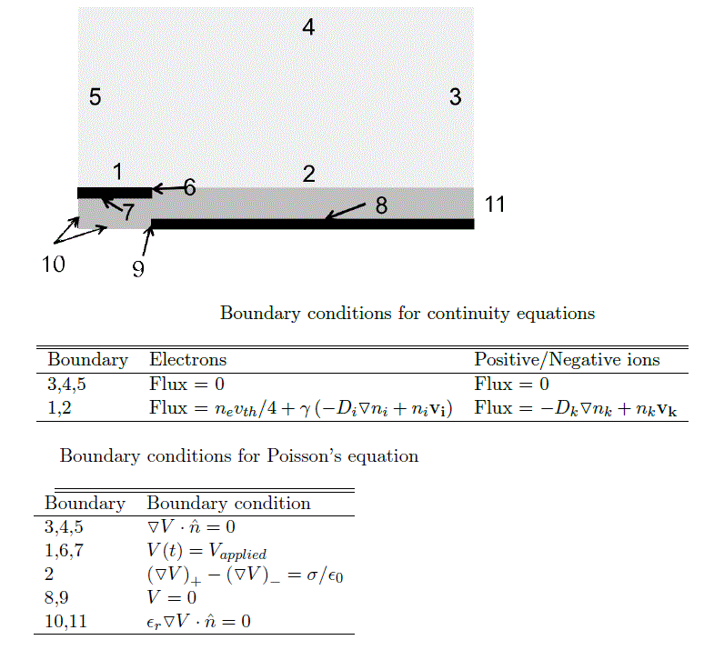

I feel that this problem can be due to not defining a wall and surface charge accumulation, but when I do that (and i have to do that) the model gives me an error and is unable to calculate the hs.ebar(electron energy density), though I correctly define and route the variables from respective modules.
I have attached my model and the desired boundary conditions (BC.jpg). The Poisson equation is solved for dielectric and the air domain.
It will be very gracious of you if you could help me Sir. I appreciate your help.
