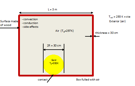

Let us suppose that a sphere (radius R) made of gold is located on a infinite surface made of wood. The system is enclosed in a box (length L) filled with air with a finite size. The sphere is very smaller than the dimensions of the box (L = 20 R).
The initial temperature of the sphere (Tis) is known, the initial temperature of the air in the box is known (Tib < Tis) and also all the relevant parameters of the system (calorific capacities, heat transfer coefficients...).
I would like to calculate the temparture of the sphere as a function of the time Ts(t) by taken into account :
- the thermal transfer between the sphere and the air (convection...)
- the thermal transfer between the sphere and the surface of the box on which is posed the sphere (convection, conduction...). The influence of this surface on which is posed the sphere is not negligible !
- the side effects due to the finte size of the box.
Up to now, I solved the the problem only when the box is supposed infinite with a sphere that floats in air (cooling of a sphere embedded in air) but how to set COMSOL to solve the problem above ? In particular to take into account the surface on which the sphere is posed ?

To be clearer, my sphere is enclosed in the box fulled with air. The sides of this box are made of wood and the system {sphere + box} is embedded in air (infinite medium). According to experiments, the finite size of the box is to be taken into account in the calculations of the cooling of the sphere and all of the physical phenomena relating to the cooling of a hot body (convection, conduction...).
The box represents a wooden house...The design can be seen in attached file.

You need the overall heat transfer coefficient of the wood wall, k_tot:
1/k_tot = 2/k_(a/w) + h/l_w
where k_(a/w) is the heat transfer coefficient between air and wood (I do not know where to find it), l_w is the heat conducivity of wood and h = 30 cm (thickness).
Next, what is the contact area between the gold sphere and wood? Can be a point.
Provided that these constants are known, the problem is solved. Use the Newton's cooling law for the heat flux between interior and exterior air (the latter is constant): Q = k_tot*(T_out - T_in).
At the contact of gold and wood yet another heat transfer coefficient is needed. If no BC is given here, the temperature profile is continuous, T_gold = T_wood.
The contact gold-air in the box can be treated in various ways, perhaps a thin barrier could be the simplest solution.

For example, there are 4 walls in a square box enclosing area L^2. A circle of the same area will have diameter L sqrt(4/π). If you get this working well then you can switch to the more detailed 3D model.

I used Newton's cooling law everywhere at the phase boundaries:
heat flux = k*(Ta - Tb)
Whether it is called convective or general expression does not matter because that is the equation used in the simulation. There is no convection in the model.
Because we have two physics nodes which meet at the phase boundary, the same boundary equation must be presented for both of them, only the sign is changed. When the solid wood receives heat, q = k*(T2 - T), air inside the box looses the same amount q = -k*(T2 - T) = k*(T2 - T). But I made a short cut: I expressed the heat loss of air inside the box with the overall heat transfer coefficient, as I described earlier in this thread.
T is the temperature in solids, both wood and gold, the only difference being in their material properties; T2 is the temperature in the air inside the box. In the Heat Transfer in Solids node, Heat Flux 1 is the cooling law between the outer surface of the cube and the exterior, Heat Flux 2, describes heat transfer between the inner surface of the cube and inner air, Heat Flux 3 heat transfer between the gold sphere and air.
In the Heat Transfer in Fluids node, Heat Flux 1 is the loss of heat across the wooden walls, as explained above, and Heat Flux 2 heat transfer from gold to air; this is equal to Heat Flux 3 in the solid node, only with the sign reversed. Maybe this confuses you that T is the temperature variable for both wood and gold.
I just put the sphere resting on the bottom of the box, giving a contact point, because I did not know where to put it. Is it hanging in the air?
I wish I was clear enough :)

In my problem the object is in fact a half sphere placed on the ground at the center of the room. From your model, I just add a heat flux node to take into account the heat transfer by conduction (q = -k dT/dx) between the sphere and the ground (the surface of the transfer is pi*R^2) but, I feel that this latter term (Fourier's equation) is not necessary to be added...
