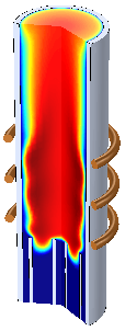

Could you describe the main settings in this model (attach file from highlights Comsol 5.0)?
This file is real and right picture of icp torhes.
