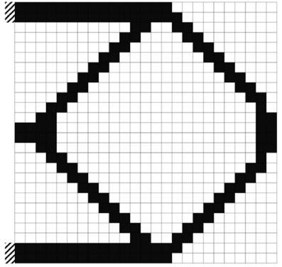

I´m trying to apply topology optimization to the design of compliant mechanisms using COMSOL optimization interface.
As a first exercise I´m working on an Inverter Mechanism (please see this paper for more details: R. Ansola et al. A simple evolutionary topology optimization procedure for compliant mechanism design. Finite Elements in Analysis and Design 44 (2007) 53–62).
I think I set up the problem correctly but for some reason COMSOL optimization solver can never converge ("Returned solution is not converged." / "Forward solution failed: requesting reduced step." / "Adjoint solution failed: requesting reduced step." / ), though the solution isn´t too far from the expected one (check the result in 2D Plot Group 6) .
This is a very simple problem and there must exist a solution in the form of the attached figure. I might be wrong about the definition of the MPE, but the SE is probably correct because it is automatically calculated by COMSOL as solid.Ws .
I based my model on the Model Library Example called "Topology Optimization of a Loaded Knee Structure". However the example model focus on maximizing the structural stiffness (by minimizing the Strain Energy - SE). For compliant mechanism, which is my case, we need also to consider the maximization of Mutual Potential Energy - MPE. To simultaneously accomplish the two requirements of maximizing MPE and minimizing SE a multicriteria objective needs to be defined. I used the following formulation: Min ( - MPE/SE ), which is the same as Max ( MPE/SE ).
