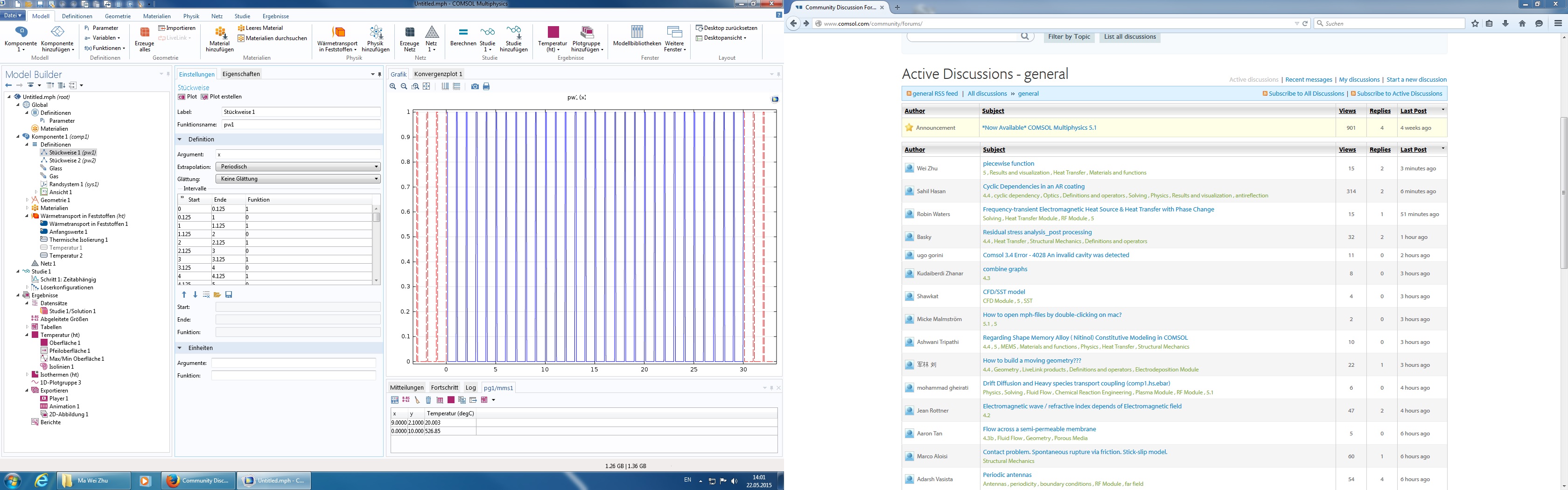

Thanks for you answer. But I still have a question. How to understand that the time not coincide with the stepwise function? Because at first period, the result at 0 to 0.125s is correctly 1, but after that, the result of function is always 0. I'm sure that the stepwise function is correct, because I have also seen the waveform, every second it has a high value.
[QUOTE] Probably your time stepping does not coincide with the stepwise function. Lasse [/QUOTE] Hi Lasse, Thanks for you answer. But I still have a question. How to understand that the time not coincide with the stepwise function? Because at first period, the result at 0 to 0.125s is correctly 1, but after that, the result of function is always 0. I'm sure that the stepwise function is correct, because I have also seen the waveform, every second it has a high value.

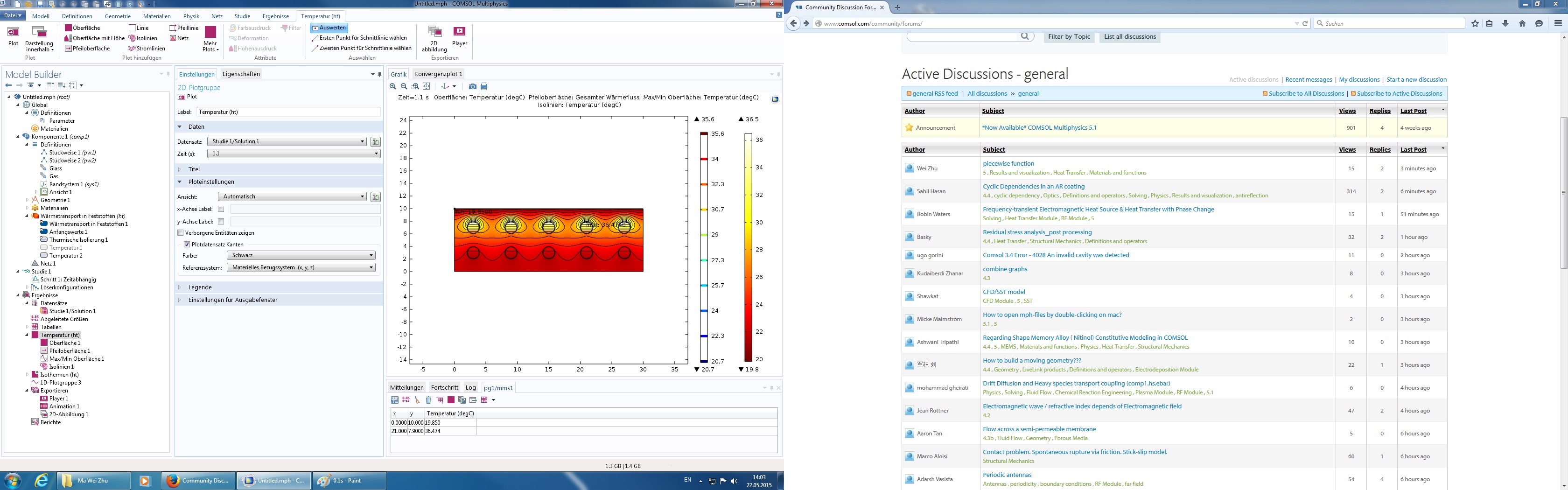

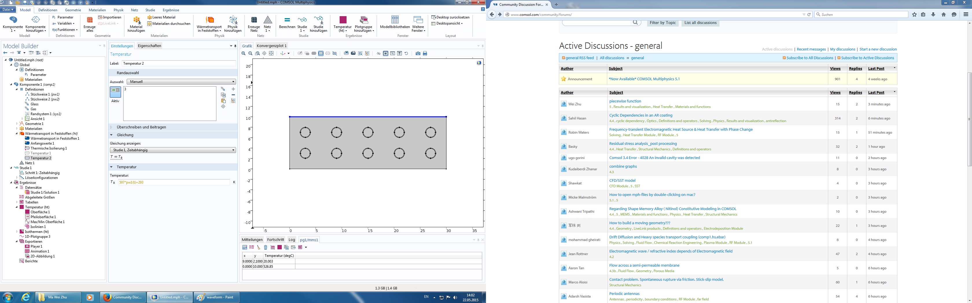

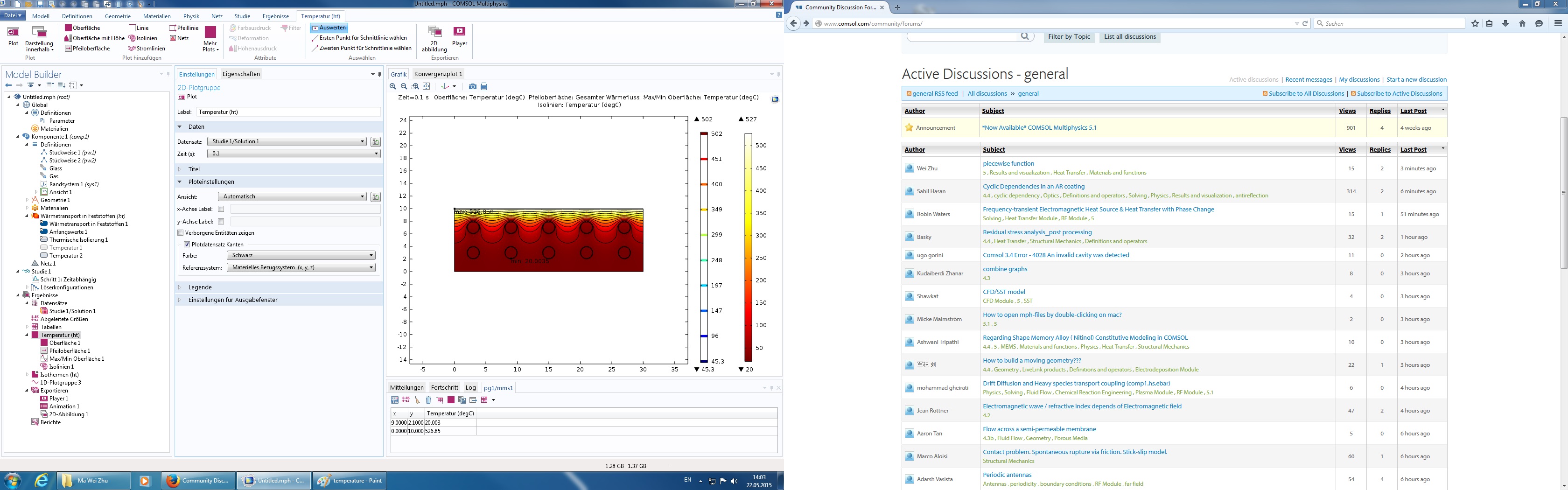

Thanks Lasse. I have upload some pictures about the waveform, the temperature, temperature distribution at 0.1s, at 1.1s. So the problem is the temperature at 1.1s.
[QUOTE] I mean that when the solver takes time steps, it may jump over your pulse. I had this problem a few years ago, when I had a very short pulse every hour. I had to define solver time stepping explicitly so that the solver was able to "see" the pulses. Lasse [/QUOTE] Thanks Lasse. I have upload some pictures about the waveform, the temperature, temperature distribution at 0.1s, at 1.1s. So the problem is the temperature at 1.1s.
