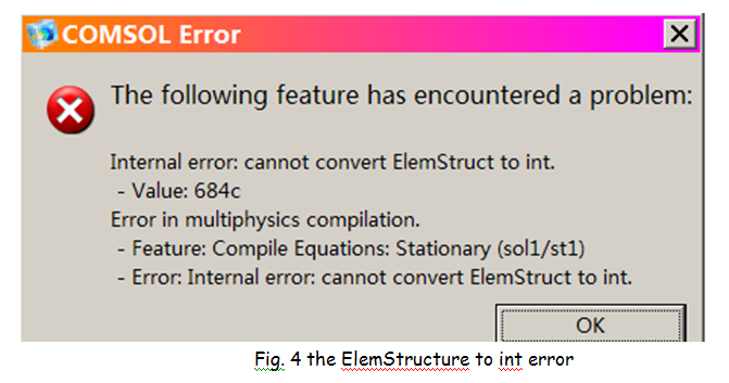

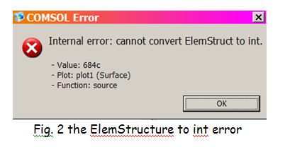

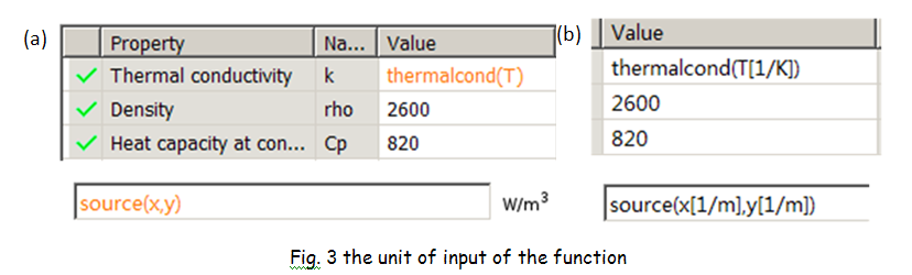

I have downloaded the .m and .mph files, and also encountered some problems. furthermore, some puzzle still exists. Is there anyone can help me? Thanks sincerely in advance.
(all the text and photos are integrated in the .doc file, please see the .doc file , thanks)
Files:
extfun_heatcond_q
source.m
thermalcond.m
The above two .m files are put in the directory of matlab, and the .mph file just on the computer desktop.
When open the “extfun_heatcond_q.mph”, I can see the surface plot (under the “Results“ branch) of heat source, conductivity, temperature, which are illustrated in Fig. 1.
Fig. 1 the surface plot of temperature (a), conductivity (b) and heat source (c)
I turn to the matlab node (Global Definitions –MATLAB 1), which is an external matlab function and includes thermalcond and source functions.
Question 1: expression in the “Derivatives” term
There is no expression in “Derivatives” term, I wonder when do I must specify the derivatives?
Question 2: convert ElemStructure to int error when plotting
According to the guidance from the documents (new 4.2a edition), the external matlab function can be plotted only in COMSOL (do I misunderstand?). So I add the data ranges (two data sets because there are two arguments in function) in ”plot parameters”. Then I click the “Plot” to plot the function, but fail, and the error “Internal error: cann’t convert ElemStructure to int” occurs, just like Fig. 2.
Fig. 2 the ElemStructure to int error
Question 3: about the unit in the material property
I check the model whole with the hope of making it clear. Then I found the thermal conductivity is defined using the external matlab function “thermalcond(T)”. While it shows orange-coloured, and implies “unexcitable unit of input”. The T in the COMSOL model have its inherent unit ‘K’, if using “thermalcond(T[1/K])” instead, the color is black (means no error). The “Heat Souce” in the Heat Transfer model node is similar. Is there any difference between them?
Question 4: the ElemStructure to int error again when solving
Then, I click “Study” to calculate the model. However, the following problem occurs just similar with the situation when I try to plot the function only before.
Is There anyone give me some tips and guidance?
Thanks sincerely in advance. Best wishes to you and your family.
FM Huang
Dec.4th.2011
