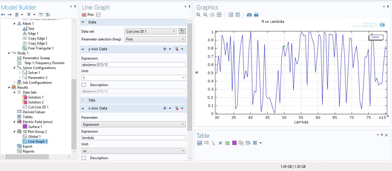

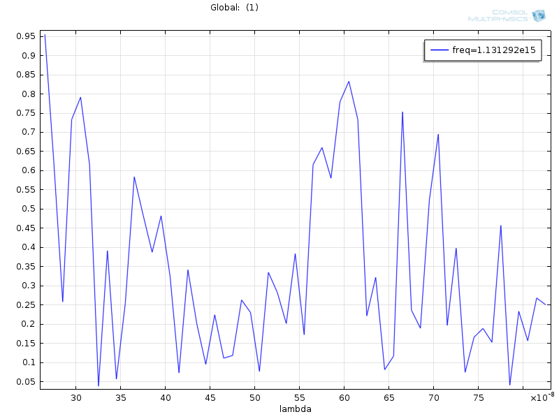

I am still not able to resolve the issue with the simulation. I have attached an image of the simulation results.
Also when I use a flat surface without any features, I am not getting the right reflactance values for higher angles of incidence but for normal incidence the values are correct. I am starting to wonder if that is the reason the simulation with features is incorrect as the values of reflectance for higher angles of incidence are incorrect.
Any comments on this would be appreciated. Thank you.
Could you share your model file.Then I can get an idea about what might be the problem.
