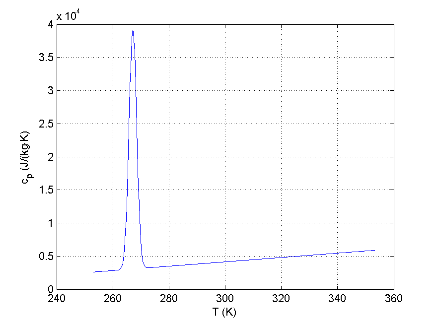

We are carrying out a simulation campaign in order to evaluate the temperature pattern and thermal behavior of a standard-shaped object. The temperature range concerned includes a phase change for the aforementioned material, from solid to liquid. As you well know, the phase change can be modelled through a particularly-shaped Cp (specific heat capacity - see Fig. 1). The preliminary results of the simulations showed temperature values outside the phisically-relistic range.

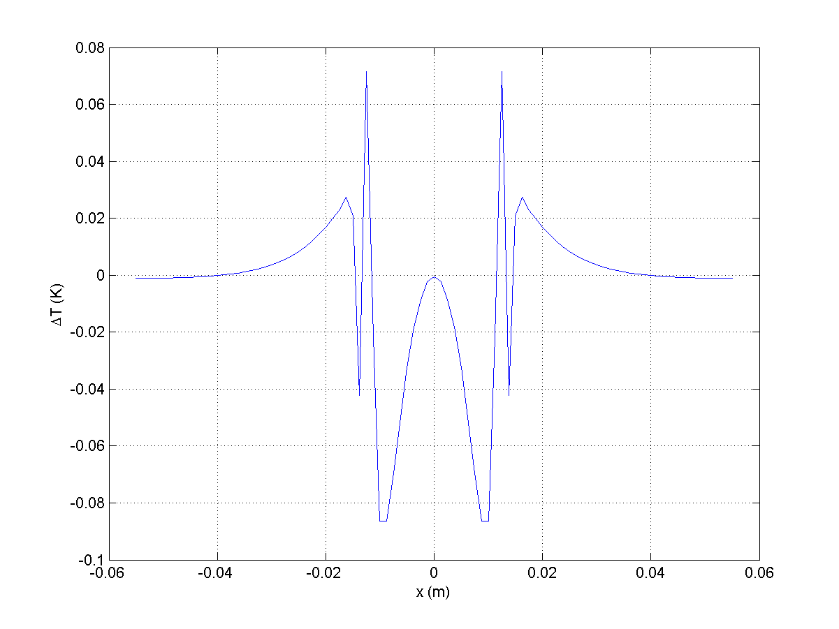

We compared the COMSOL simulation results with a Matlab script implementing the Crank-Nicolson FDTD method with the same parameters, same mesh definition and same conditions. Please find attached (Fig. 2) a plot of the difference between the final temperature values as obtained by COMSOL and by the Matlab script. As you can see, in correspondance of the phase change the error presents an unexpected behavior.
Although the magnitude of the error may be not that worrying, we suspect that this behavior may detrimentally affect the 3D simulations.
