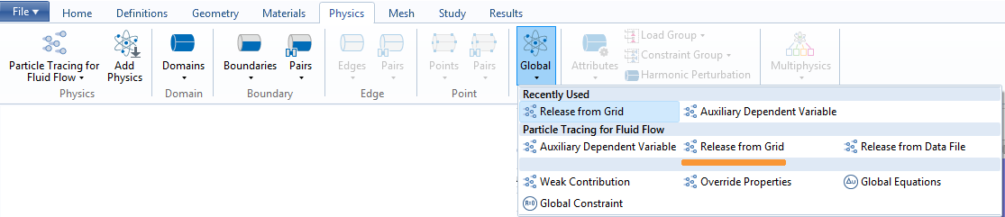

My model is 3D, and I want to specify in particle tracing module to release particles from this specific location which has coordinates (x,y,z) and I want to impose to release particle every 10 cm (for 2 meter, 20 particles) along the z direction.
Do you have any idea how is it possible to impose it inside the particle tracing module?

you can use the "release from grid" node to specify the release of particles on specific locations (found under global conditions).
