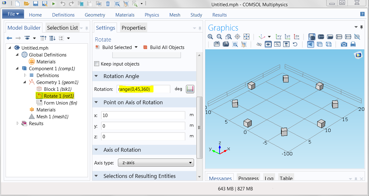

Dear Daniel,
please see my attached file - and - in case you are not running COMSOL 5.1 yet - the screenshot.
Sven
Dear Daniel, please see my attached file - and - in case you are not running COMSOL 5.1 yet - the screenshot. Best regards, Sven
