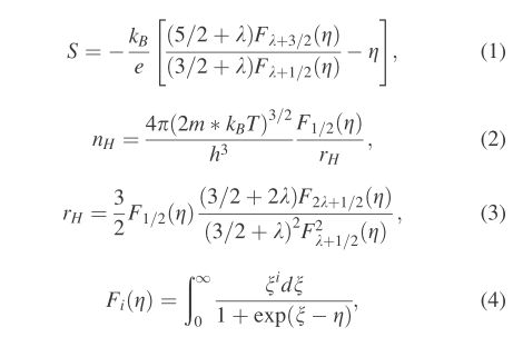

Reg. Calculation of effective mass by MATLAB software
Posted 21.08.2015, 02:06 GMT-4 1 Reply
Below i attached equations, how to perform the below equations and help me programming code. I know two parameters ( S and nH values), by using these two parameters i want to find the effective mass value.
Please help me regarding this problem
