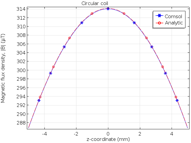

Alessandro,
Attached is model file with comparison to analytic solution.
Sergei
Alessandro, Attached is model file with comparison to analytic solution. Regards, Sergei

Posted: 1 decade ago 14.09.2015, 12:02 GMT-4
Alessandro,
Attached is verification model in v.4.3.
Sergei
Alessandro, Attached is verification model in v.4.3. Regards, Sergei
