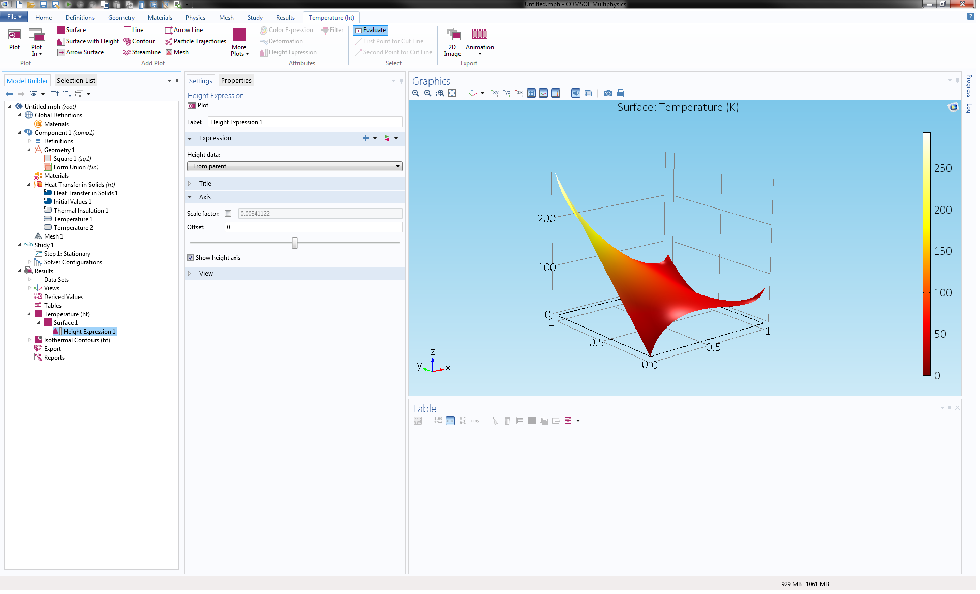

Hi Paul,
Are you thinking of a graph where the value of T is represented as a surface whose elevation depends on x and y?
If so, you can do that using a "Height Expression" node, see attached screenshot.
Hi Paul, Are you thinking of a graph where the value of T is represented as a surface whose elevation depends on x and y? If so, you can do that using a "Height Expression" node, see attached screenshot. Best, Jeff
