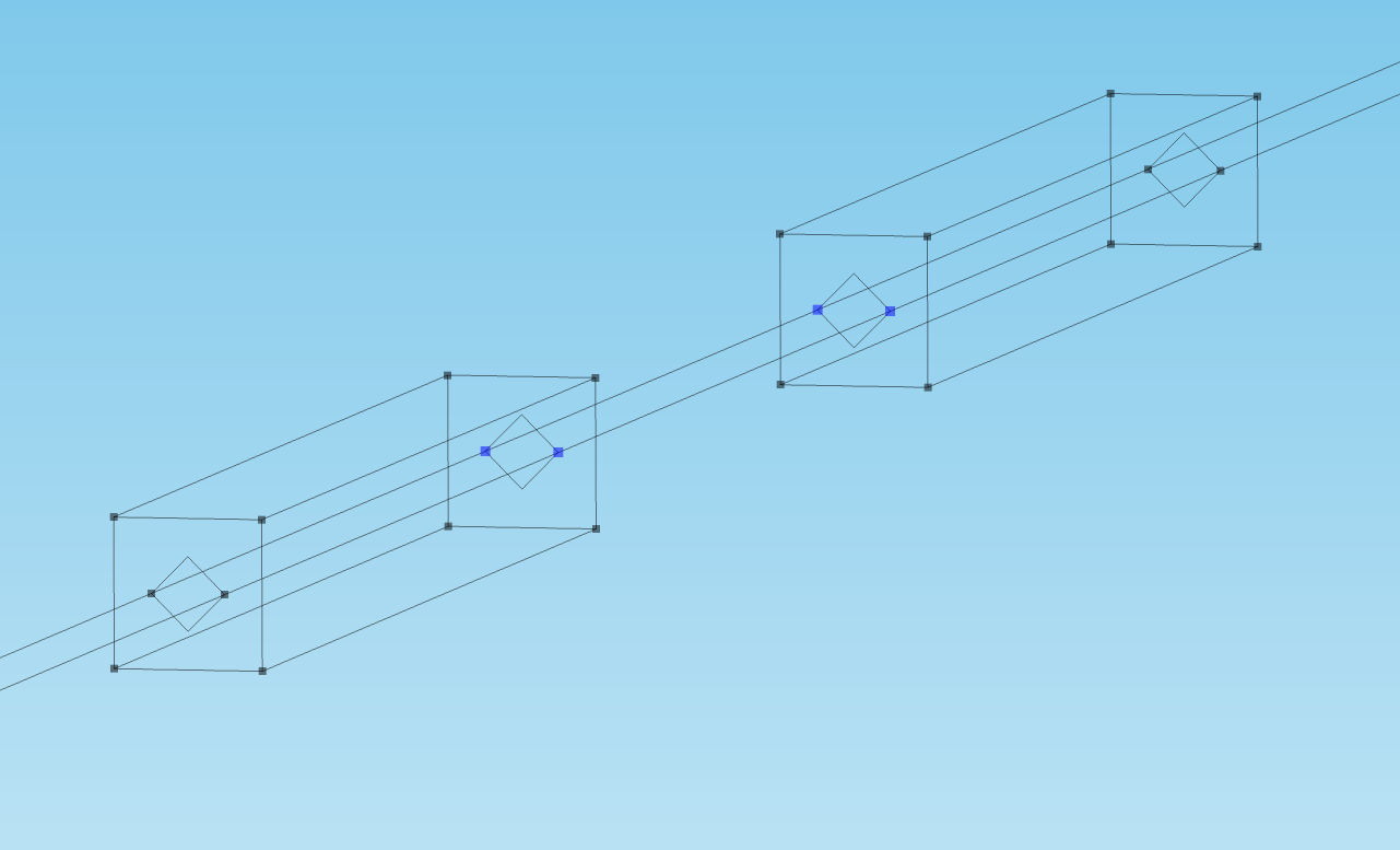

This should be an easy answer but for some reason I cannot find it in Comsol 4.0a. I have a fiber that i am heating up and I want to pick points on the fiber so that I can measure the displacement but only in the fiber direction (the z direction in this case). I know how to do a total displacement after the solution is solved, but not a z direction dependent displacement for a point. My problem is that I have this fiber sitting on a large metal tube and when it heats up, it expands in all directions. Thus the total displacement of the fiber is not realistic. If I can get the z direction displacement I can find out how much the fiber is stretching as a result of the heating up process. My overall goal is to calculate the strain (delta L) /(initial L) in units of microstrains ( 1 per million) by using these displacement numbers.

Hi Ivar, Thanks for your response. Yes the u, v, and w sounds like what I want. Where can you find these and how could I apply them for the 4 blue points in the picture I have attached? Also you mentioned the min, max, and average operators. Where can I find these to apply them in my model? Also would the first principle strain be the same as (delta L) /(initial L)? If not what should I be looking for in the postprocessing to get this type of output. I am unfamiliar with working with the heat transfer side of things since I mainly do research in the RF package so please forgive me.

So u,v,w are the variables (default for displacements in COMSOL) and you need to define yourt points (set them in a selection Definition) (right click the "Definition" node and look carefully through all items, you will find the min, max, average, integration etc oprerator there too (there are mosty several layers of subnodes to pass, the "gems" are often hidden rather low in the three structure ;) then you apply the operator on these points. Once solved in the postprocessing you might call up the operator, or just look indicidually (unfortunately postprocessing does not accept an array :( would be nice ;) and you get the values in a table.
One thing, ormally point values are averges from the surrounding lines/surfaces and can be strongly influenced by their neighbours. Therefore I always check that I have a sifficient mesh density, and I average over an area covering enough elements (approaching St Venants principle) rather than picking points (or I define a metrology probe point in the middle of a surface, so it gets an extrapolated value but not directly the one of the adjacent physics border
