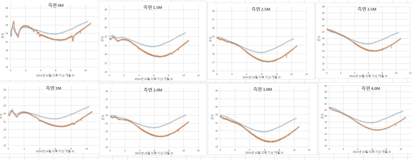

My goal is to compare numerical analysis results with field test results which are both time-dependent.
Briefly explaning the geometry in my model, i have Soil, Rocks, Concrete. If you see my attached file please(i will send it by email if anyone can really feel into it), you can easily find out how they are aligned and designed.

Regarding the results, the time range is about 10 months, starting from winter to summer. When i compare the results with field test data, both results were almost close at the very beginning up to 4 months but it starts to have a big temperature difference after 4 months which the weather (out temperature) starts to increase. ( the difference is up to 2~2.5 celcius).
And when i plot a graph, it seems like there is a bit time lag in my model and i cannot find exactly what the reasons are.
Will you guys please find why it happens ?
