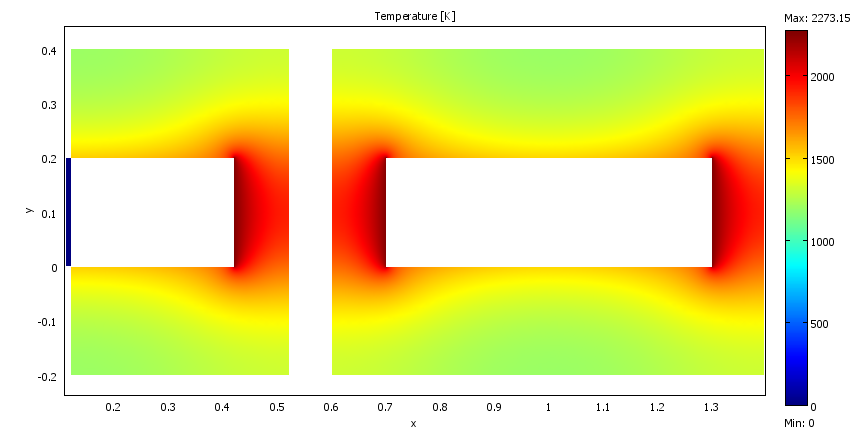

If you enable radiation (Heat Transfer Modul), you can't utilize symmetry, because COMSOL "looks through" the (open) symmetry boundary.
To demonstrate the issue, I have attached a MPH-File. (just click the "solve" button)
Have I done some mistakes? How to set up the model correctly, to take advantage of symmetry even with radiation?

I'm afraid you are slightly too quick in your conclusions, there. For me your two cases are different.
First of all you should use a radiation "group number" different for the 1/2 part and for the 2*1/2 parts.
Then if you integrate the total normal heat flux on the three (right) interior boundaries of your 1/2 model and the 2*1/2 model you will find quite a lot of differences.
For me you have no "symmetry" boundary on the left 1/2 model, as you have excluded the opening. There you need a perfect mirror with no absorbsion.
Furthermore if you look at the final temperature with a line cut (i.e. from (-0.2 0.2) to (1.4 0.2) you will see a rather large difference for aour two models

Usually, if you want to model "pure" heat transfer of the right "2*1/2"-model, then you would feed COMSOL with the left 1/2-model, because it HAS a geometrical symmetry boundary . Then (no radiation) the results would be the same - no difference between left and the right model. But if you activate radiation, then you get differences between the left 1/2-model and the right 2*1/2-model, as you told me correctly. Do you know what I mean?
So my problem is, if you have radiation, you can't utilize (geometrical) symmetry boundary. To solve this, i thought about a small black plate on the "open" boundary. The results of the "open-blacked" 1/2-model showed good agreement in comparison with the right 2*1/2-model.

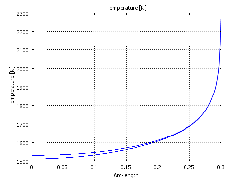

this is exactly what i have tried: a fully reflective boundary. It works quite well (see temperature_distribution.png), but there are still some differences between the results of the 1/2 model and the fully 2*1/2-model (see temperature_boundary6vs21.png). I adjusted the 1/2 model with a small plate wich covers (almost) the whole hole. The boundaray, which "looks" inside the chamber, has a temperature of 0K and has surface-to-surface-radiation with an emissivity of 0. Physically this should be a fully reflective boundary with no radiation from the plate itself, or?

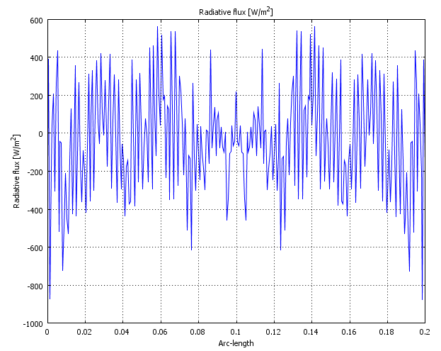

But how can the difference be explained which are still left? Numerically unprecisions, since the reflective boundary has an radiative flux which is not zero (as you can see in picture radiative_flux_boundary7.png)? I would say, that COMSOL (V3.5a) can't provide an real refelective boundary, even with an emissivity of zero: If radiation energy comes from inside the chamber to the "refelctive" boundary, then the energy is absorbed and immediately emitted. But emittance does not care about the income angle (as it is correct for thermal radiation!), it is distributed along lamberts cosine law: J(alpha) = J0 * cos(alpha). For an real reflective boundary, it should be J_emit = J_absorbed but only in one direction: alpha, respectively alpha'. ???

probablky yes it could be numerical issues, as your flux is rather spiky. Have you tried to integrate fully over the area ? and see whathappens when you refine the mesh a few times ?
